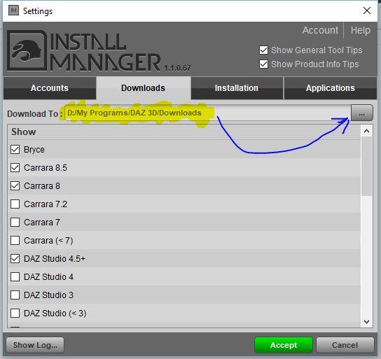

  • StezzaStezza Posts: 8,882
    edited April 2017
    SileneUK said:
     The DIM downloads alone send me into the red zone for the drive filling up. Happily the  E: is about 2 TB as is the external F  also being 2TB.
    yes  Silene
    You know you can change the download location of the files in DiM to your bigger drive... cool
    544 x 513 - 48K
    Post edited by Stezza on
  • DartanbeckDartanbeck Posts: 21,988
    Stezza said:
    yes  Silene
    I love how customizeable DIM is! yes
  • SileneUKSileneUK Posts: 1,977
    Stezza said:
    yes  Silene
    Oh, doh blush.... I didn't think about THAT option. Cheers both!  kissheart Silene
