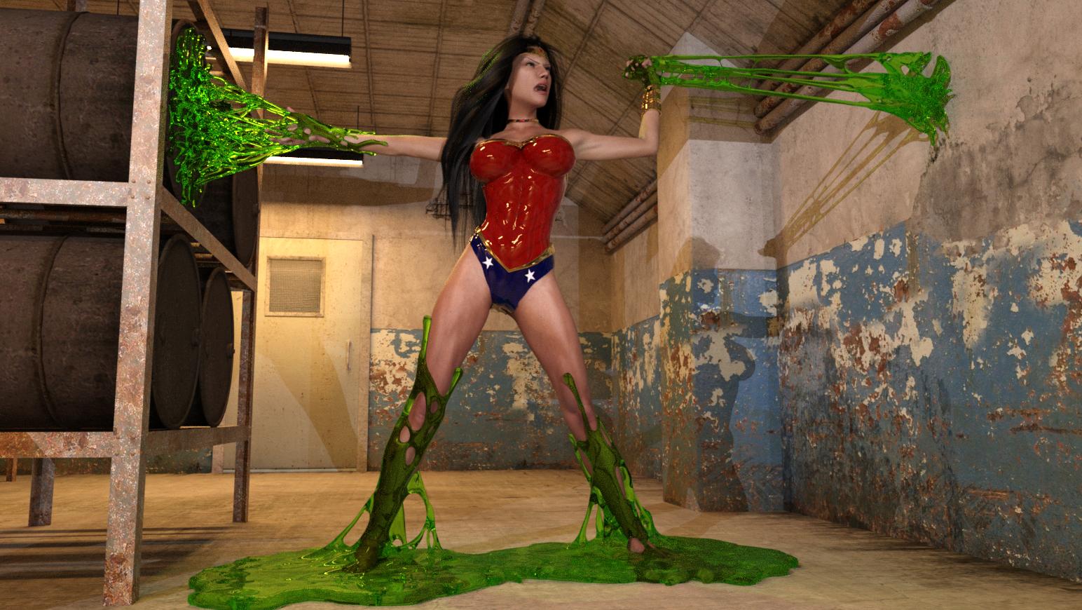

    Here is a trick to give it some more versatility. On the props that load outside of the body, like the hands, feet, head, etc, load the prop, then load GF3 and pose, now parent the prop and save as a smart prop. Then save a partial pose where the slime is on the figure. This way you can combine more than one set of props and poses in a scene. This test scene has 3 different props/poses combined
