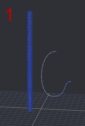

Thought I had shown this, but here is a quick (once you know) way to create a 3D helix in Hexagon:-
1:- 2 cylinders just for start/end of 3D helix
2:- Create 3D path. Collapse DG when path in correct position.
3:- Increase number of points on path (I made it approx 500)
4:- Create line at one end of path
5:- Sweep line along path and add twist (I made twist 20000). Collapse DG when done.
6:- Select outer edge_loop of sweep
7:- Copy/paste which leaves new helix path (I have hidden sweep so you can see helix)
8:- add thickness to helix path (add sub_d if needed)

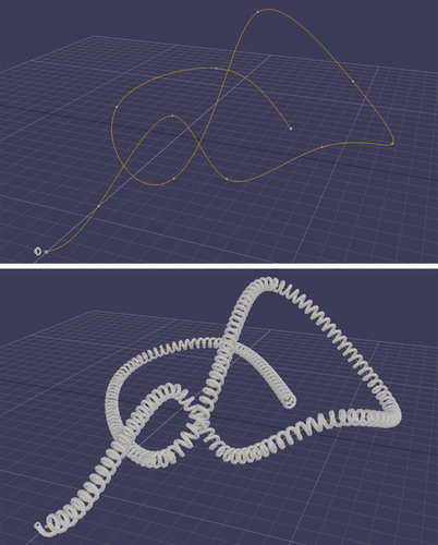

Expand your toolbox by using NVIL (Voidworld) for making things like cords. http://voidworld.cmcproductions.co.uk/index.php?board=2.0 (currently free )
Quick example from NVIL.

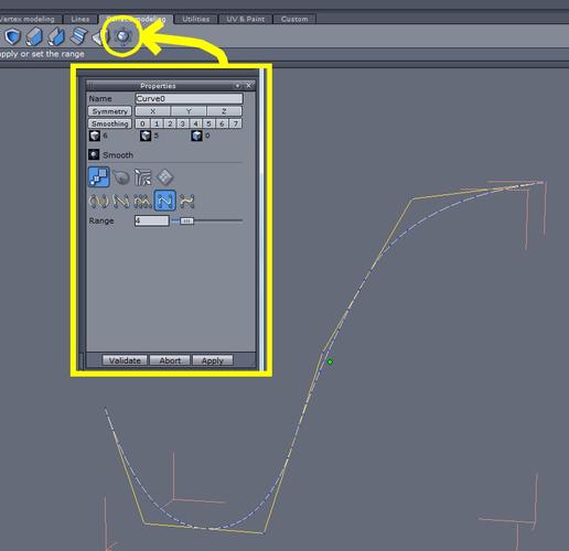

BTW - how do you get 500 points on the curve? I have seen a method by E-Z to quickly tessellate a curve, but can't for the life of me remember - all I can do is repeatedly select and tessellate. The subdivide tool won't go above 20.

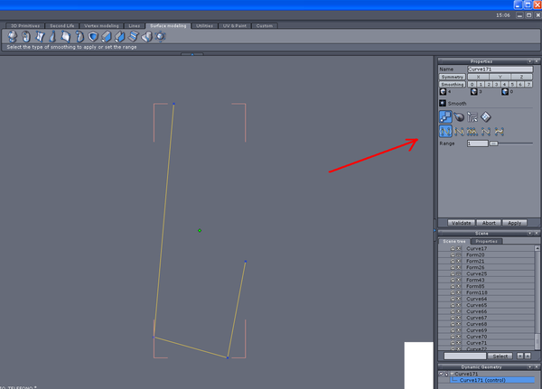

I did find that using the smoothing tool, under surfaces I could get an approximate equal distance between the points.
(The original curve is in yellow)
But I have no idea on how many points there are.
So that would be by trial and error with the range selector, until one finds something that can be used.
Plenty good enough for making a twisted cord.
And in real life there are always some stretching in a cord like that.

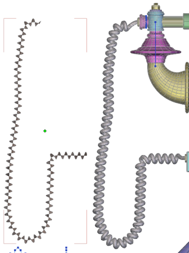

The night brings advice.....
:cheese:

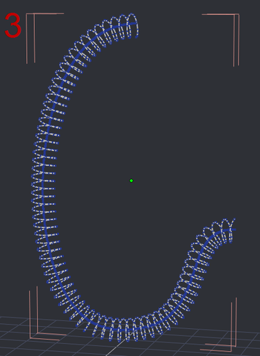

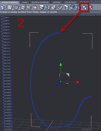

lines:
one by one
:long:
then
constructed path
then
added points
then
applied system "Steve"
then
touch-up
Ciao
Hi m_m_italy,
Looking very good.

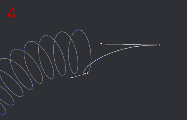

If the path is only 2D, then use "Bend" on an Helix.
1: Create Helix + Path
2: Increase number of points on path (<- important. The more points the better for bend)<br /> 3: Bend Helix to path (scale if needed)
4: Add curves to ends of Helix for connection. Weld them
5: Add thickness to Helix.
