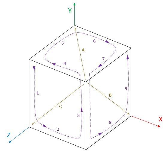

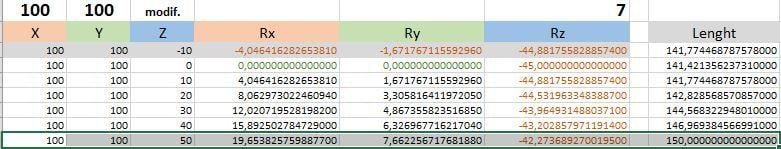

    Thanks for the information. I did the following. I made a cube (100x100x100) with a joint. I set the center of the joint to 0/0/0 and set the endpoint to different values. Each time I aligned the joint and noted the orientation values.
    For lines 1 and 2, I get the following values as shown in the table.
    Rx, Ry, Rz are the orientation values.
    I got the angles in the FBX, but how do I get a point on the axis?

    This sounds correct,but..
    when I take the highlighted value I get a length of 150. So if I use a vector of 0/150/0 (aligned with the y-axis) and rotate this vector with the angles Rx, Ry and Rz, I should get a vector 100/100/0. As the FBX does not export the End Point, I need to rely on the rotation values.
    Assuming a rotation order YXZ and a matrix calculation according to this formula
    where c is the cosinus and s is the sinus. When I take 0/1/0 as vector aligned with the y-axis and calculate the new Y-value, I get in Excel
    COS(Rx)*COS(Rz)*150 = 104.52488533131
    But the value should be 100.0000. So this isn't an matrix rotation.

    I can not check your formula, but I can simply generate bone and rotate it with my assamption, as same as daz studio (in joint editor)
    see, I set bone with size 1.5  along to z axis first, (0, 0, 150) ( I need to change cordinate for blender, Z up, -Y)
    then rotate  by global Z axis  first , use your excel. Ry 7.662,
    next rotate by local X axis , use your excel value, Rx 19.6538  (blender is clever enogh to rotate with rocal axis presiselysmiley)
    then finally rotate by  global.Y axis (apply minus because blender Y face back)  Rz 42.273
    I can clear see, the end point of bone, locate ( 1, 1, 0.5)
    then I think my assamption is right about each orientation and which axis is used for.
    OK, I have to look at that. When I work according to the standard Euler rotation (https://en.wikipedia.org/wiki/Euler_angles, in the second part of the page), I get a difference. I made a short animation (you have to unpack the ZIP and play the mp4). You see how the expected orientation and the calculated orientation differs from a certain point on.
    I have to check Blender, how they calculate it.
    Thanks for your inspiration.

    Hi there,
    I can confirm that the rotation order for the joint's initial orientation is XYZ. This is totally independent of the rotation order and this was very confusing. You were completely right and solved a huge issue for me. Thanks, Thanks, Thanks a lot!!!
    The second line leads to the correct values and I'm able now to do a quaternion conversion for the joint. This is perfect!
