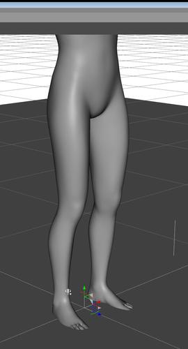

  • squirrelysquirrely Posts: 160
    wancow said:
    Can you post some screen shots of what's happening?
    attached in order
    see in the frames were the character moves into the crouch that the feet go under the ground plane
    And have you tried pinning the feet?
    yes ... i pinned the feet in both translation and rotation right away up front
    they are kept in place at frame 0 and 4 ... but not in between
    thanks
    frank
    701 x 1300 - 237K
    701 x 1300 - 234K
    701 x 1300 - 229K
    701 x 1300 - 228K
    701 x 1300 - 229K
