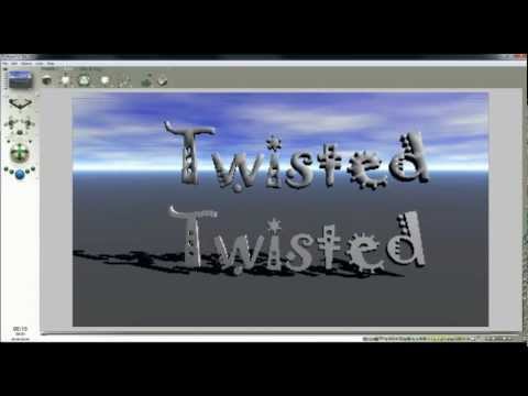

I have a nice little text program which works very well in Bryce, Elefont by Armanisoft.  I have quite a collection of dingbats too.  I was now wondering how one can turn them into neon signs and how one can do this in Bryce!?  Any ideas?

    Elefont is cool, I have it for years. With Ambience, the letters can be made glowing. You can also light them with a square parallel light in front of the text. The light can be scaled. Then include only the text object.

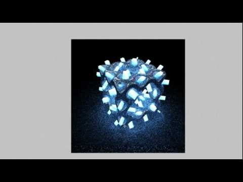

    I experimented with lighting this morning. The 1st one is David’s Obscure Glow tutorial and the 2nd Super reflective neon effect. You can see from the render that the effect works on the mesh but not on the Elefont text.
    David posted some cool examples. Hope they help you solve your problem.
