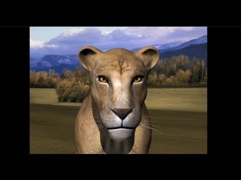

    Not that I now of, you'll need to do it your yourself. It you do it in DAZ Studio, it is best to use animate2, keymate, graphmate add-on in combination with the Puppeteer / PowerPose tools. The PowerPose & Puppeteer are part of the free DAZ Studio but you will have to buy animate2, keymate, graphmate in the DAZ 3D Store.
    This animation for the Millenial Lion will give you hints how to approach the task:
