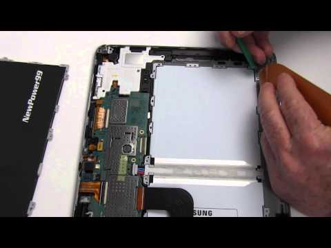

    I am guessing that you are no longer in a warranty, but if you are, take advantage of it. I looked this tablet up and this one looks very easy to open up, one of the easier Samsung devices to take apart for sure. The phones are practically glued together, but this tablet's back looks to come off very easily. Any little plastic shimmy could work, like those plastic spackle spreaders or even an old credit card. The parts inside are all modular, and most of the fancy stuff you want to avoid is safely tucked away from the battery, so you are much less likely to mess up something.
    I found a little video that shows it all step by step.
    If nothing else, you could pop it open to see if the battery is bulging anywhere. You could reseat the cable, and who knows, maybe that would work.
    If you replace it, the trickiest part would be the ribbon cables. They are very easy to do, but they are also very easy to mess up if you don't pay attention.
