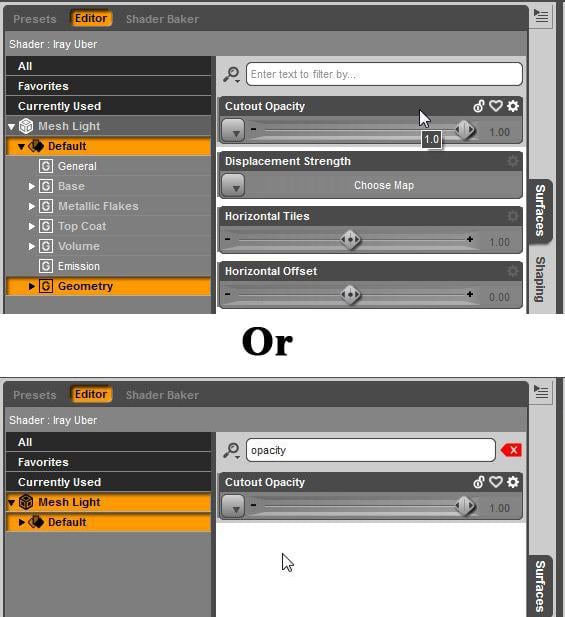

    Cutout Opacity is found under the Surfaces>Editor tab. Select the mesh light in the Scene tab, then select the mesh light in the Editor. Double-click the Mesh light in the editor tab and you should see subsections of the parameters. Click on Geometry and Cutout Opacity will be the first parameter listed. Alternatively, you can select the mesh light in the Editor and type Opacity in the filter field and Cutout Opacity will be the only parameter listed.
    Where to find Cutout Opacity in Daz Studio parameters
    As I stated in another thread, Kindred Arts posted a tutorial on how to create Ghost Lights here, which you may find helpful. (I used what I learned in that short tutorial thread before the Iray Ghost Light Kit was released, but I still bought the product when it came out, and consider it one of my better investments.)
    565 x 617 - 159K

    "Mesh Lights" are geometry (mesh) with emissive surfaces. A plane, a sphere, part of a larger model, etc. Cutout Opacity is an Iray parameter on objects. Painter's Lights combines Render Setting environments with spotlights. Spotlights do not have Cutout Opacity. You would want the Render Emitter set to off. If the light is too strong, you would want to lower the value in the Luminous Flux (Lumen) parameter of the light,
