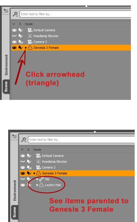

However, now, when I use Leyton Hair or Sapphire hair, it applies the hair to the figure, but it doesn't appear in the environment.  For instance, I select Genesis Female 3, and then Leyton hair.  It applies the hair to the figure and you can see the figure with the hair.  When you click parameters to see the objects in your scene, I can see Genesis Female, but Leyton Hair is not a choice, even though it's in the scene.

    Are you expanding the entries for the base figure - by default fitted items are also parented to their wearer.

    In the Scene pane, click on the little arrow point to the left of Genesis 3 Female. It will "expand" to show any items that are parented to Genesis 3 Female.

    Thanks you very much barbult. It's funny, when I first started to use these hairs, they were showing up as a separate objects.  Then I got that weird message, and after that i couldn't see it when I loaded it, so I said great, my system is now screwed over an upgrade. :)  Anyway, I'm glad that there's a reasonable explanation, thank you very much for taking the time for supply visuals as well, greatly appreciated.
    Update:  I opened the program, I got that weird message again that system configuration had changed, blah, blah.  Before I did anything I did a "scan known directories for files" and then did a refresh.  I tried to do what you said in the above and these are the results.  This was not showing up last night.  As you can see, the Leyton hair is showing up on it's own.  The only thing I could think of is the scan for files brought it up.  However, thank you very much for your explanation, should I have issues in the future, I will definitely look at the files the way you mentioned.
