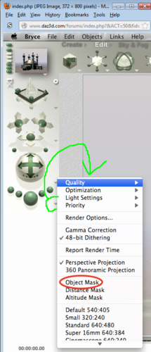

    Hi,
    Yes you can selectively render any or all parts of a Bryce scene, or at least you can render the whole scene and then render a separate mask layer of all the parts you need to see.
    You'd then need to open the original render and the mask render into a photo editor and add the mask layer as an alpha channel then save the picture in a format that you can use in Daz Studio and which supports alpha channels.
    You would then in effect create two sky domes in Daz, one for your Daz sky and one for your Bryce scene (with the alpha channel effectively leaving the sky transparent so you could see the Daz sky instead).
    The option for creating a mask render can be found in the render options (see attached picture).
    372 x 800 - 169K
  • ThePatrickThePatrick Posts: 0
    Hi TheSavage64,
    thank you very much, yes that looks very good to me!
    Do you have experience with it? What I effectively want to have, is using different skies that are compatible with the lighting I want but using surroundings (hills, mountains, forrests and that sort of) from different sources. There is for example a massive pack of different skies with lighting available in the pack "Skies of Economy" but those don't contain mountains and the sort of. It would be great to be able to combine that stuff and get more flexibility this way.
    One additional question would be (if you have done such things before) if the lighting will be Ok this way. The mountains or other stuff should look different with different skydones+lighting. I understand, that shadows will not change on a plain image, but at least the colors should look somewhat realistic (I am also not so firm in lighting though).
    Last question: How do you get that popup-Menu your picture shows in Bryce?

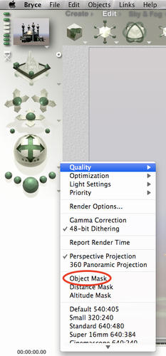

  • srieschsriesch Posts: 4,243
    edited February 2013
    Click on the bottom of the 4 little triangles on the left. Anytime you see one of those triangles in Bryce, there's a menu available.
    378 x 881 - 246K

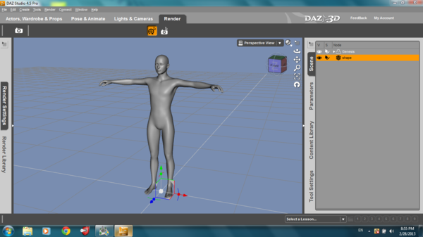

    I didn’t want to start a new thread, so I thought that I would ask my question here.
    I am trying to send material from Bryce 7 to Daz Pro Studio, but it doesn’t seem to be working. The strange thing is that the scene tab in Daz Studio shows an object (I tried to send a tree), but nothing is visible in the viewer panel. Any idea what might be going wrong?
    I don’t want to give up on Bryce- it seems like such a great product., and I really want to create environments for my Daz characters.
    Thanks!

    Is it possible that it somehow imported very small, out of view, or takes a long time to import and isn't quite there yet, or just jammed up halfway through the import? Try selecting the object and framing it, see what happens.
    Hmmm. I only have part of an answer for you. If I try to send a tree across the bridge, I either get an error or nothing happens. However, I can get the tree to transfer (sort of) by exporting it in Bryce and importing it in DAZ Studio, like this:
    With the tree selected in Bryce, from the menu bar select File > Export Object. In the "Export tree" window, make sure neither the trunk nor the leaves pictures are greyed out (unless that's what you want; clicking on the text toggles them), perhaps experiment with the slider to get better results, and click on the checkmark. In the "Save As" window, browse to a temporary folder of your choice, change the filename to have no spaces (the default value might have spaces, and this will not work correctly.) Change the "Save as type:" dropdown to "Wavefront OBJ Files (*.obj)" (I haven't experimented with the other file types) and press the Save button.
    In DAZ Studio, from the menu bar select File > Import and browse to and double-click on the .obj file in the temporary folder you created. In the OBJImportOptions window, change the "From" dropdown to "Bryce (1 unit = 8ft)"
    However, the default resolution and materials don't look too good on the trunk in my random test. Of course you can't directly use Bryce materials in DAZ Studio; I'm not sure exactly what Bryce is doing to arrive at the material it exported, or what a wider selection of tree materials might look like when tried. Also the earlier warnings about import/export file locations and .duf scenes will apply.
    Hey Sean, thank you for your help.
    Your suggestion that it might be an issue of scale or where the tree was showing up in the picture was totally plausible. However, when I framed the tree, it was located at the center of the plane, and increasing the scale to the max didn't do anything. Very good ideas, though.
    I tried your suggestion for saving the tree as an object and importing it, and it worked like a charm! As you said, the materials and resolution weren't the best, but at least it is a start. I now have something I can work with, which is more than I had before you answered my question.
    Thanks again for taking the time to help me out.
