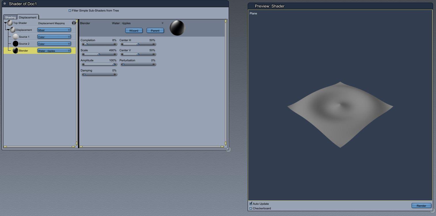

    Try looking at the "shockwave" preset for the particle emitter as a possible starting point. It kind of does what you say you don't want - that is, the particles just expand outward rather than staying in place and moving up and down with the wave (if I understand what you want), but maybe you can get from the preset to your desired result somehow?  I don't know, just throwing the idea out there.
    Alternatively, maybe you could use a ripple texture in the displacement channel on a plane somehow? Set the scale high enough to get a small number of rings and animate the completion parameter to make it move outward?

    Shoestring Shaders has a "Drip Shader" that can be used in the displacement channel....this drip can be animated to spread the ripple, and can have multiple ripples.
    If you wanted particles to ripple, use an invisible plane as your particle emitter.

    Using shader displacement (Water : ripples) plus a Terrain shader gets an interesting result.

    I don't think the surface replicator respects animated displacement on the object either.  I did a quick test replicating some spheres on the displaced plane I showed above and the replicated objects just stayed in one place as the displaced plane moved up and down through them.
    I had an idea of making a grid of small spheres that are all one vertex object and applying the animated displacement ripples to that but when I tried to test it the displacement took forever to calculated on all those spheres. :(
