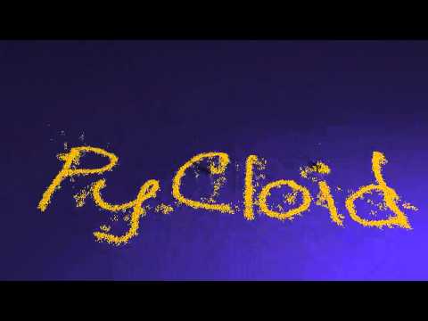

  • DartanbeckDartanbeck Posts: 21,970
    Have you ever tried PyCloid? I haven't yet, but I bet it would be helpful in addition to what MDO is demonstrating
    Here's a demo on PyCloid Magnets
    Image Based Emission
    In this one, he's using the magnet properties to send the particles from one object to another

    Here's my PyCloid demo video playlist, made with Frederick's permission, if anyone's interested. I think they're really cool to watch ;)

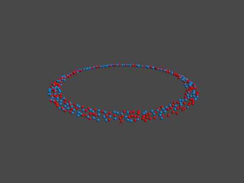

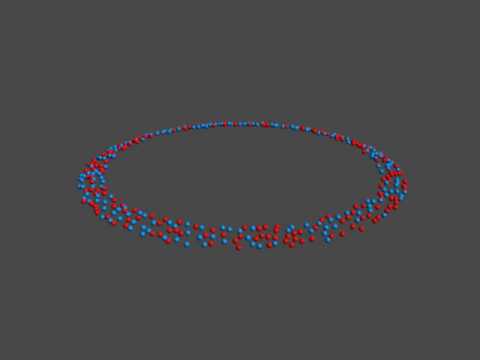

    I read your post again and I did it backwards but this should be close to what you want, it is easy to have the particles move from the center out.  What should have worked using the Wave deformer  and Surface replicator caused carrara to get confused.  Here is the Carrara file if this helps .
     I used the surface replicator and created morph targets to shrink the ring of particles and to mimic the wave action.

  • mmoirmmoir Posts: 827
    I reversed the direction the particles moved and added a morph target to contract/compress the width of the ring
