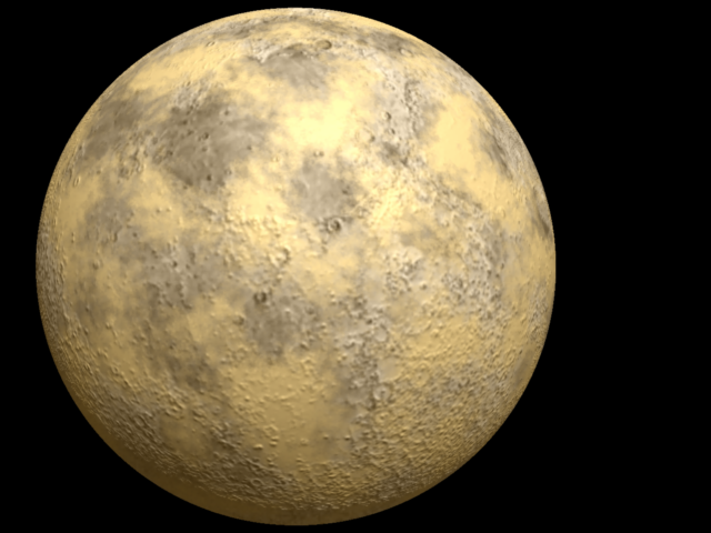

    Objects I modeled for the above project, Spooky Night, also known as Spooky Hollow.
    The Moon... my version. This was made much better for the animation by Dartanbeck. I created this from a simple sphere in the vertex room and added Smoothing to make it look much rounder... nice smooth edges.
    The Signpost... my version. mmoir beveled the corners, impoved my simple, too perfect, look for the sign, added a nail and also a texture map for the text. Looks a lot better in the video. Also a vertex object with 2 polymeshes, one for the post and another for the sign. The post was created by making a path then dropping in a square shape to follow the path using the Path Sweep tool... I later addded a crack for where it was bent.  For the sign I used Create 3D/Cube specifying the size and segments and later scaled it to fit the post then moved it into position and rotated it.

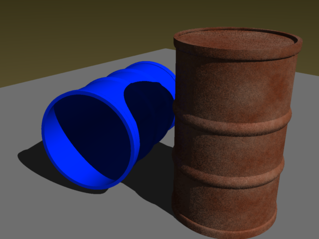

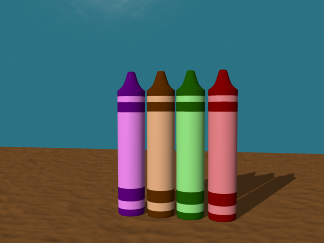

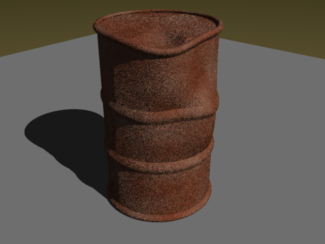

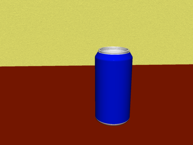

    John's Crazy Objects: A drum, a soda/beer can, crayons and a stop sign.
    I've been off modeling some simple objects for the Animation Club for Carrara, aka; ACC. I've always seem to learn something... for the last one I learned how to add morphs in the VM room and also animated the intro which thankfully mmoir added a welcome addition to to spiff it up.  Below is the 3rd ACC project that is complete.
    Some excellent and quick modelers always contribute to the ACC projects. While I've not necessarily learned to model better I have learned to model faster.  Here are pics of the objects that I modeled.
    I was unhappy with how the text turned out for the Stopsign... I'd made it a very small font size to fit the sign... Thankfully Dartanbeck suggested making it the fidelity that I was happy with and scaling it... I did so and modeled a different pole for the sign and improved the white line polymesh boarder... the new sign design appears in Carrara Monthly Challenge 29: Anachronism (incompatible time) - Voting thread see it in my Entry.
    Post edited by wgdjohn on

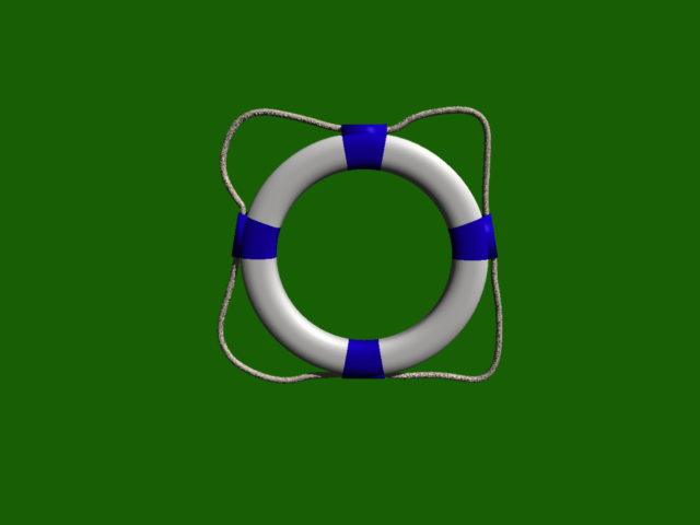

    John's Crazy Objects:  A Life Buoy
    Don't laugh. :)  this is my first attempt... there are a number of things wrong with it.  I took a few shortcuts to be able to create it in one day... yeah I'm that slow. It contains 3 polymeshes. The preserver, the loops and the rope itself.  Tools used are easy to use and are "Lathe" for the buoy ring,  I then "copy/pasted", not necessary, a polygon from that result and used "Extrude" to make a stack of polys so that I could use "Deform/Bend" on the stack to form a half pipe or loop for the future rope to go through.  Last was the rope... changing "Polyline" tool to "Interpolated Curve" to draw how/where the rope should look and go.  I spent the most time on getting the rope to fit into the loop holes without appearing to look too badly.  I'll be doing this all over again since I know where I went wrong and can do things more easily.
    Where? you might ask can you find out how to use the tools mentioned: Lathe, Extrude and Polyline tools and more are shown in DimensionT's video - Carrara Vertex Modeling Tutorial Part 1.  Deform is a modifier and was mentioned earlier ♦here♦  and later in this thread.
    Below are a few design phases... I'll not bore you with the rope.

    I just made one for myself for a bit of fun - there can be many ways to get to the same end result.  I started with the disk in the vertex modeller, with 16 edges. I extrded inwards and then deleted the middle polygon, which gave me a ring of 16 polys. Add thickness to that and add smoothing gave me the basic ring/torus shape, a little flattened  I then selected, copied and pasted a single loop and then scaled that up slightly to make a loop. Set a new Shader Domain for that, duplicate, rotate 180 degrees and move to the opposite side. Duplicate again and rotate 90 degrees - as the mid-point of the first two would be at the centre of the shape, these should already be in position.  I then made the rope by Sweeping a circle along an interpolated curve. I drew the curve from the top view and then added a little up and down movement to it before the Sweep operation to give it more character. Hope this gives you some other options.
    1920 x 1080 - 382K
