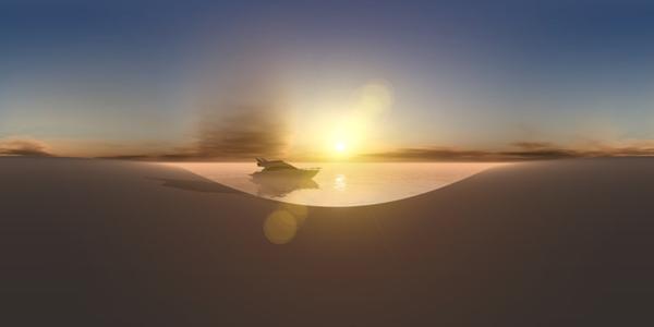

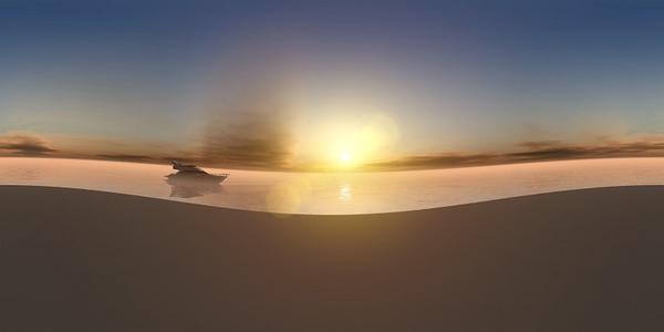

    Compare attached carrara photo to this photo: Equirectangular beach
    The linked one has two swells, versus the single lump, if you will
    800 x 400 - 26K

    It looks to me that your spherical camera is not quite horizontal. Check the "motion" parameters tab and make sure that your camera points to the horizon with an X rotation of 90 degrees exactly and zero for the other two rotations (or is it -90 - one or the other!) and see if that works.

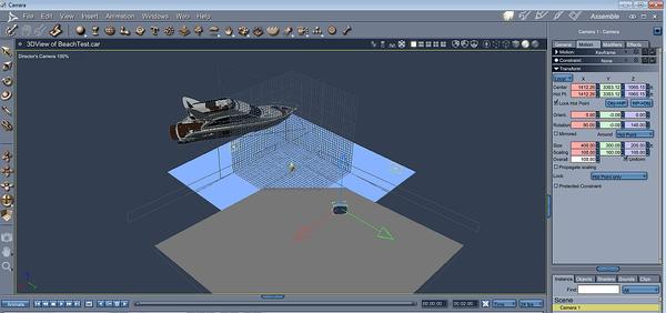

    Here is the basic setup I have.
    1080 x 508 - 112K

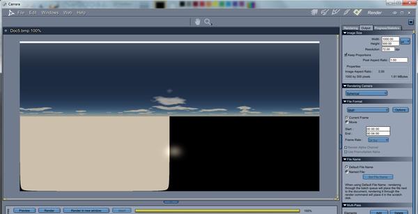

  • 3dOutlaw3dOutlaw Posts: 2,481
    ...and here is the render. Its nothing like the spherical type you have there in your sharecg stuff. I must be missing something. ????
    1000 x 500 - 29K
    OK, I may have found the problem. My focal length on my camera was set to like 75, and it should have been around 15mm or so. This may be workin.

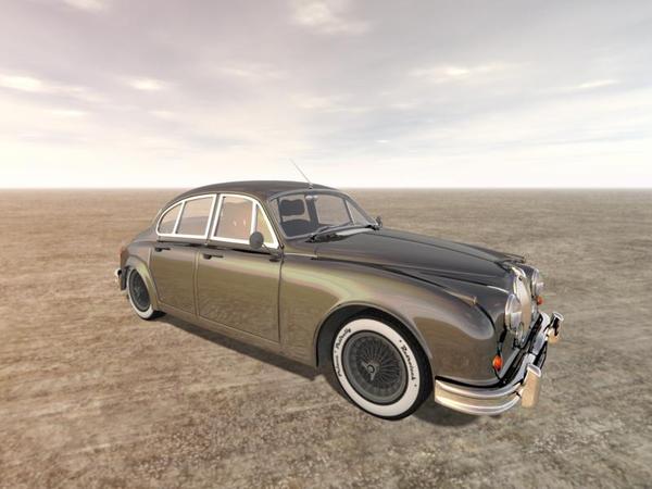

    this is a spherical environment I made in carrara, using an infinite plane with a texture, and the Realistic Sky Editor,. then converted to HDRI in Photoshop.
    The car is the "Prince" (I think),, from the Daz store, with a shadowcatcher plane under it.
    Pic 2 is the same, but with an infinite plane added, with my wet tarmac shader.
    800 x 600 - 44K
    800 x 600 - 53K
