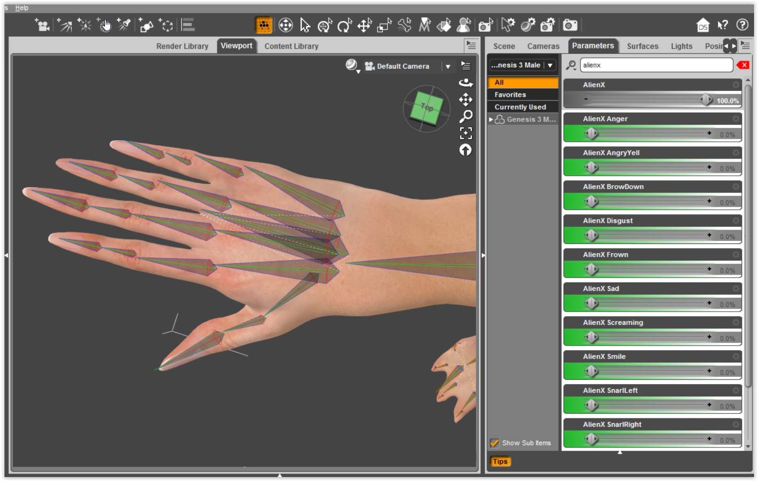

  • Here is the bones visible they are clearly short
    1632 x 1224 - 906K
  • It is likely you are having a conflict within DS from another character load. Can you do a clean install, and see if you're getting the same issue?

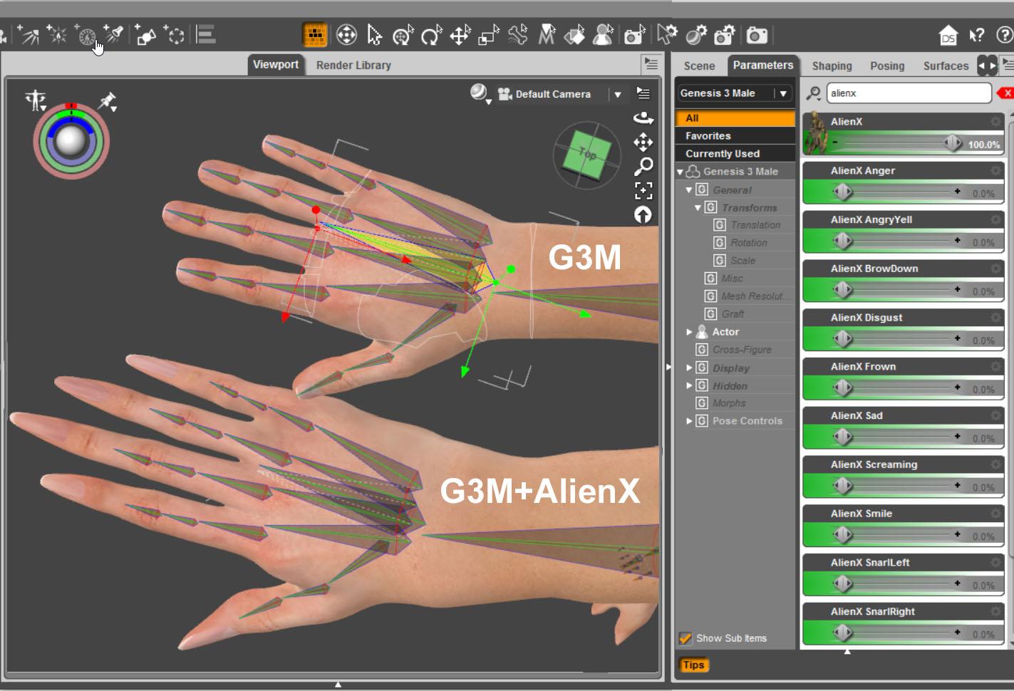

  • LindseyLindsey Posts: 2,011
    edited November 2016
    I have the same hand bone issue too with DS 4.9.2.70.  In this image loaded two Genesis 3 Males.  Dialed in the AlienX morph on the lower figure.  The Bones don't elongate when the AlienX morph is dialed in. They stay the same length as the default G3M figure. With the AlienX dialed in, when the hand is posed in a Hand Grasp, the tips of the fingers just dangle, as shown in the posted sample above, since there are no bones present.
    EDIT: The bones elongate properly with the AlienX morph applied in Daz Studio BETA 4.9.3.128
    1423 x 970 - 230K
    1532 x 974 - 809K
    Post edited by Lindsey on
