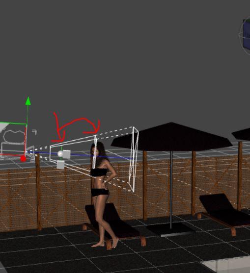

    Thank you for explaining the terms as simple as possible now I really understand the focal distant and fstop. I attached an image and is that correct? When I tried rendering it, it didnt really blur also can I ask more If it's okay :) how do you make the blurred part even more blurred? Like how can you adjust the intensity of the "blurness"? And what's the lens thickness? Also can you kindly explain to me the terms in the display section of the camera? Like the focal point scale, sight line opacity etc? By the way for the uberlight I'm using iray so can you teach me how to make an object glow and/or emit light like how a fire does in iray? I've read somewhere that glowing and emitting light are different. Thanks :)

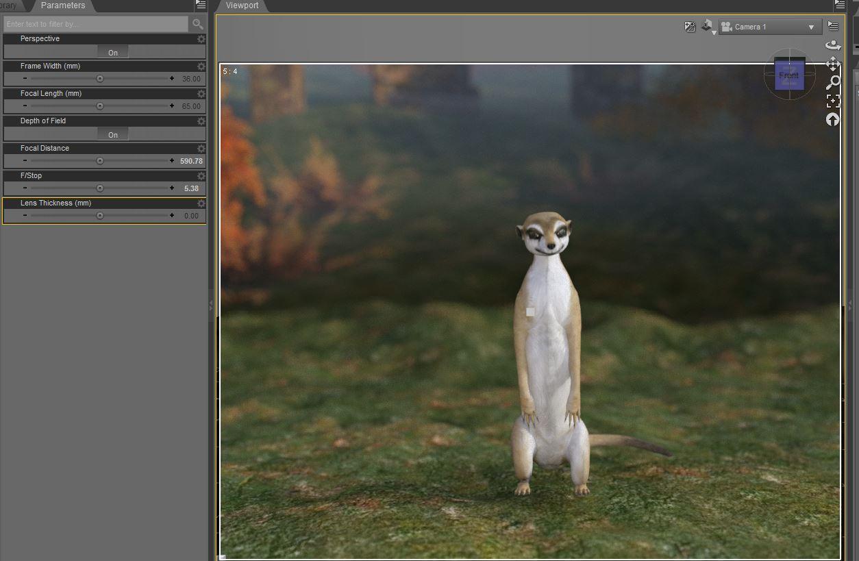

    Here's some of the things you wanted to know about the camera... I'm no expert at things, so I don't really know the physics and all, but I try to understand things as I see the effect. That means that I am sometimes quite off the track, but fortunately, there are more knowledgable people here who offer excellent explanations. smiley

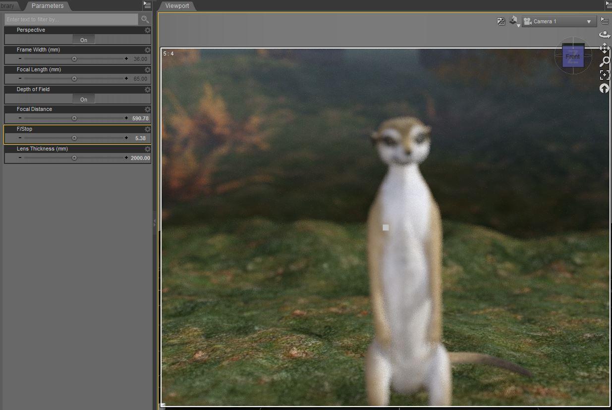

    Lens Thickness - Imagine you are looking at something. Then imagine, you are looking through a magnifying glass, or some other lense, like glasses. If you crank up this value, it will move the point of sharpness and distort the field of vision. It doesn't seem to matter if the value is positive or negative. Here's an example:
    Regular DOF:
    DOF with Lense thickness 2000:

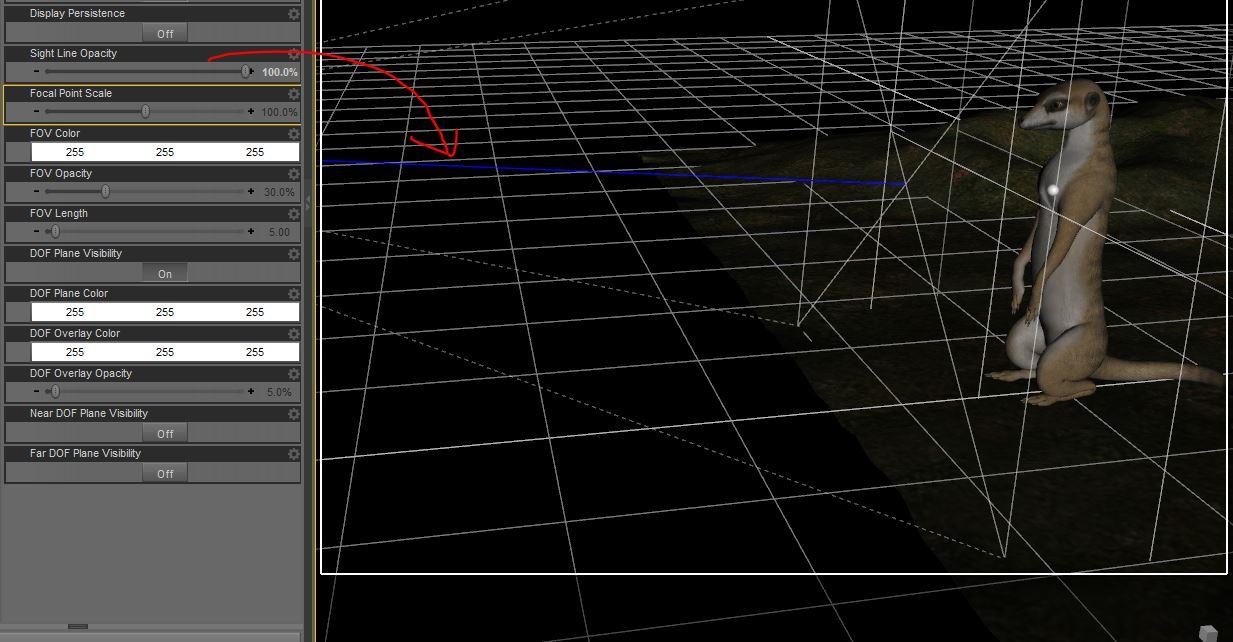

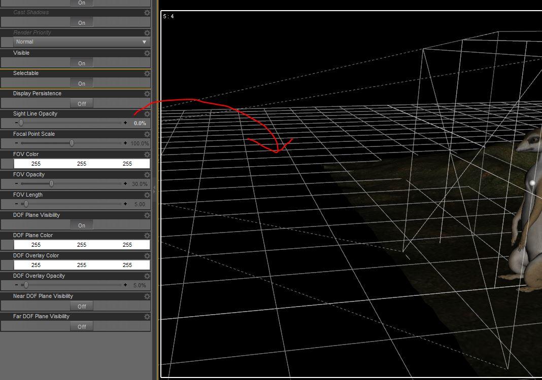

    Sight Line Opacity - The Sight Line, as the name suggests, is the line directly from the "lense" of your camera to the object. If you select the camera and look at the scene through the preview, the sight line is visible, which helps up setting scenes. The Opacity setting just says how visible that line is. It has no influence on the render.

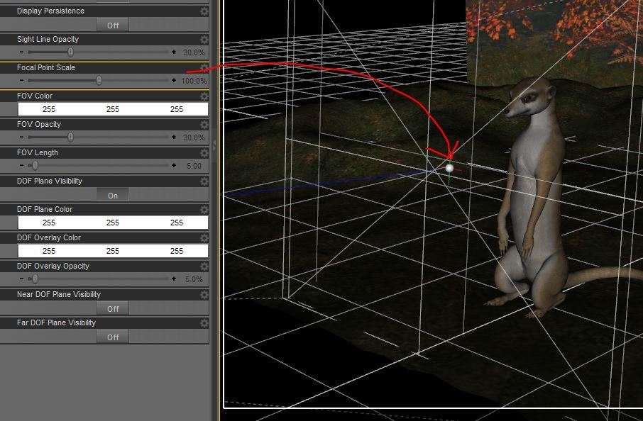

    Focal Point scale - The Focal Point is marked with a crosshair. This setting determines the size of that crosshair. It also has no influence on the render.

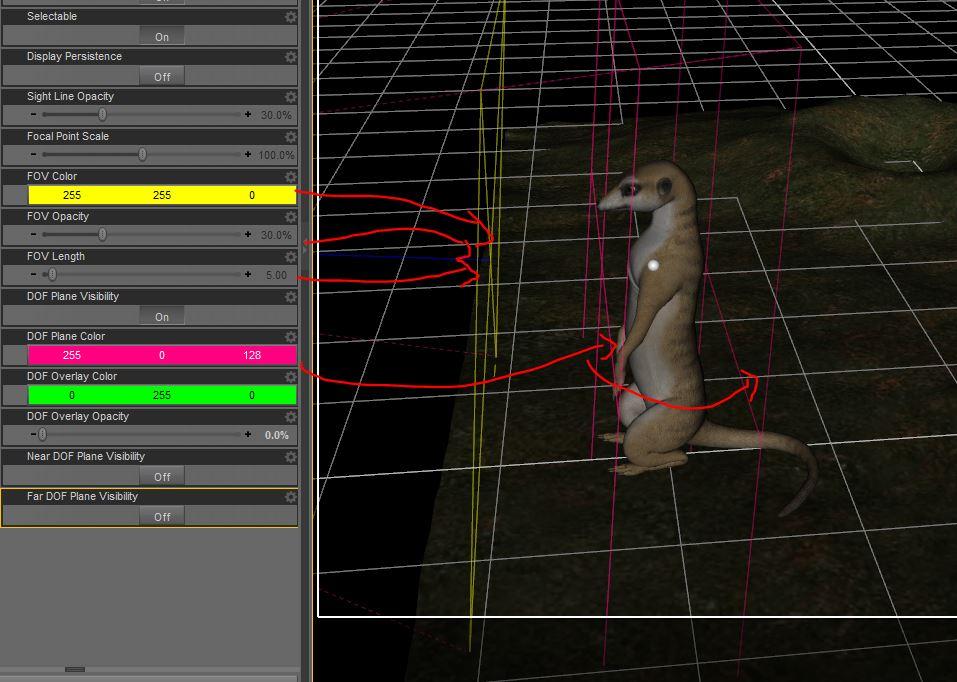

    FOV/DOF Colours and planes: you can change those to make it easier for you to see the various planes. The planes themselves give you visual aids. I haven't found out what the FOV plane does; it doesn't seem to influence the render. The DOF Plane Colour marks the near and far DOF sharpness borders. These planes are just visible in perspective view types, not in renders.

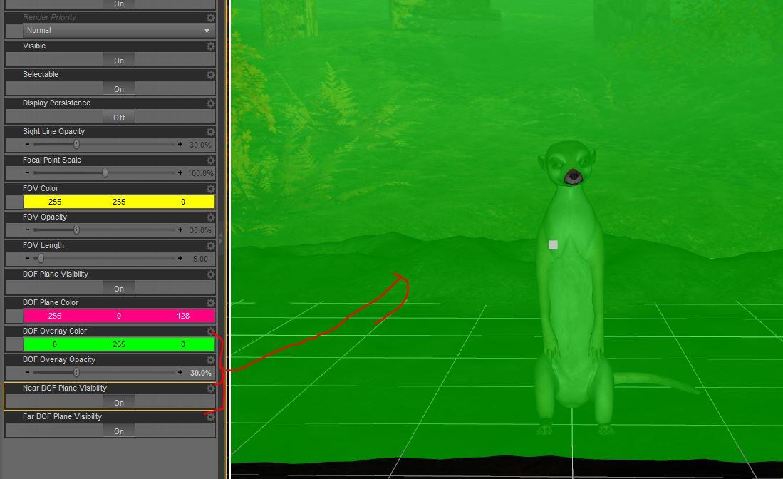

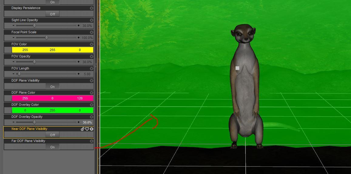

    DOF Overlay Colour: If you change back to the Camera view, and have the Near and/or FAR DOF Plaine visibility set to "ON", you'll see the border of sharpness in the image. This is pretty useful for finetuning the DOF effect. You can switch each plane on and off separately.
    Here's the front:
    and here's the back plane overly, with the front one switched off.

    @unknownmystery445 - Okay... it seems I overlooked the attached image - sorry for that!
    The problem is that you do not put the focal point (crosshair+ball) to the center of the character, where the "sharpest point" should be. Because of that, your f-stop value is very large, and you have pretty much no blur effect.
    Here's your image (btw, if you post screenshots, make sure that the people are decently covered, bikini/underwear, otherwise you'll violate the Forum TOS).
    The straight down arrow points at where your focal point (marked by the crosshair and the ball) is. As you can see, it's very close to the camera, and very far away from the girl's center (assuming that you want the girl to be the focus).
    Move the focal point further to the back by increasing the focal distance value until the crosshair&ball is roughly in the center of the girl. In the next step, lower your fstop value, until the two DOF planes enclose the girl (front&back). When you render now, the image should be properly blurred. If you need more blur, locate the center point at the nose rather than the middle of the head, and further decrease the fstop value, until the result is what you are looking for.
