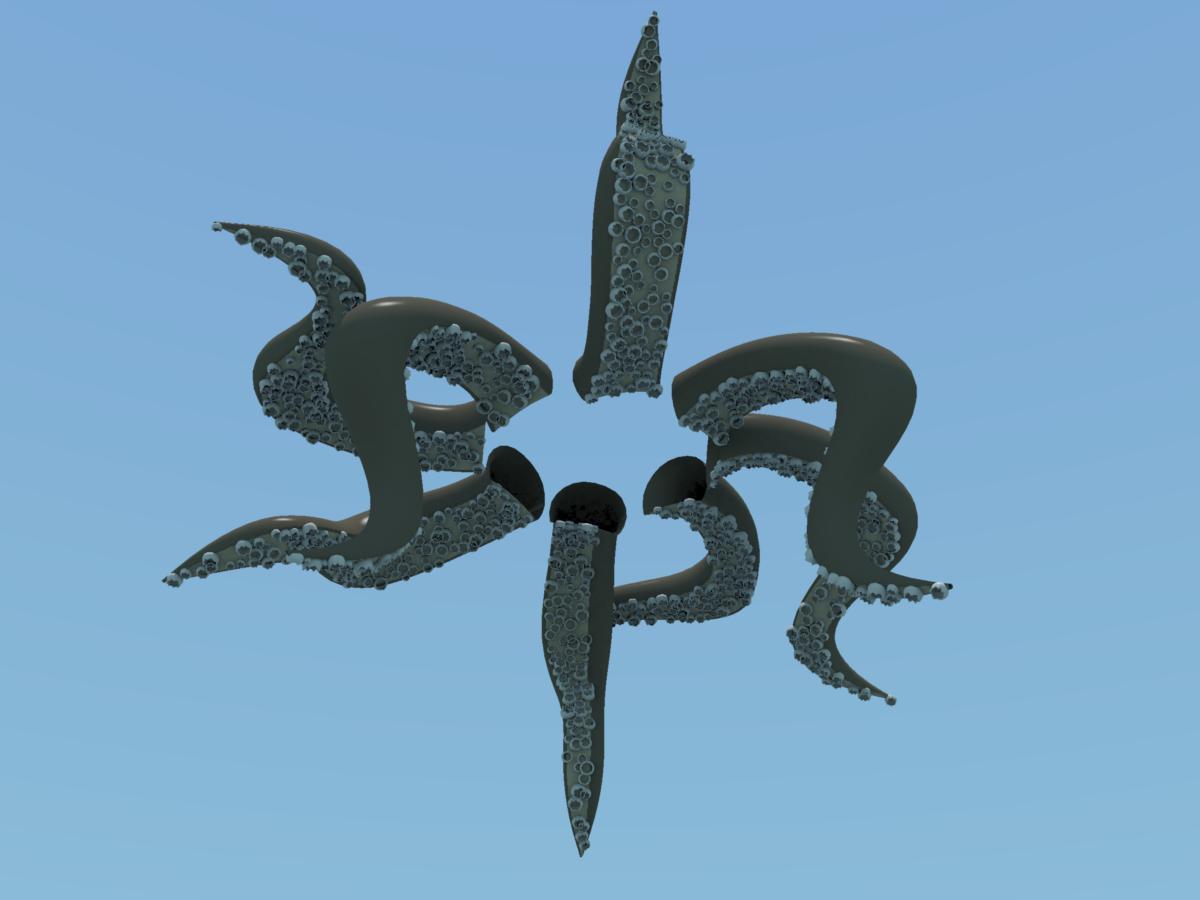

  • PhilWPhilW Posts: 5,162
    edited October 2016
    ...and a quick version of creating a range of tentacle shapes (basically from the same shapes, just rotating the cross-section), with a more sculpted flatter underside and added shading domain for that with replicated suckers. (Real octopuses have more ordered rows of suckers, but hey, this looks quite cool for a few minutes work!). Just build a body and attach the arms for a complete animal.
    1200 x 900 - 51K
    Post edited by PhilW on
  • wgdjohnwgdjohn Posts: 2,634
    Wow!  This is what happens when a Carrara user doesn't use all the tools and gets more or less satisfied with the ones they know best. The manual explains Double Sweep but only shows one example which didn't impress me. Just proves that one should always experiment with each tool take them to new levels of what you imagine.  As in life one learns to crawl first. I'm still learning how to walk and fall too often. Phil Wilkes knows how to walk circles around everyone. :)
    In the pic I've shown is my 3rd attempt to recreate what PhilW shows... even my 3 attempts only took minutes till I got something vaguely similar to his example. I also scaled my base oval to be narrower than it's its width... still needs work on each path as you can see a bit of a problem near its pointed end... fixable though. I've included a pic which highlights where Double Sweep is.
    Carrara Rocks! - Never hesitate to experiment!
    Phil,  Thank you so much.  You've inspired a need for another another of your very helpful Tutorials. "Carrara Tips and Tricks" or "Carrara - Steps Beyond" or something to that effect. I know you're working on another tutorial at the moment... can't wait. :)
