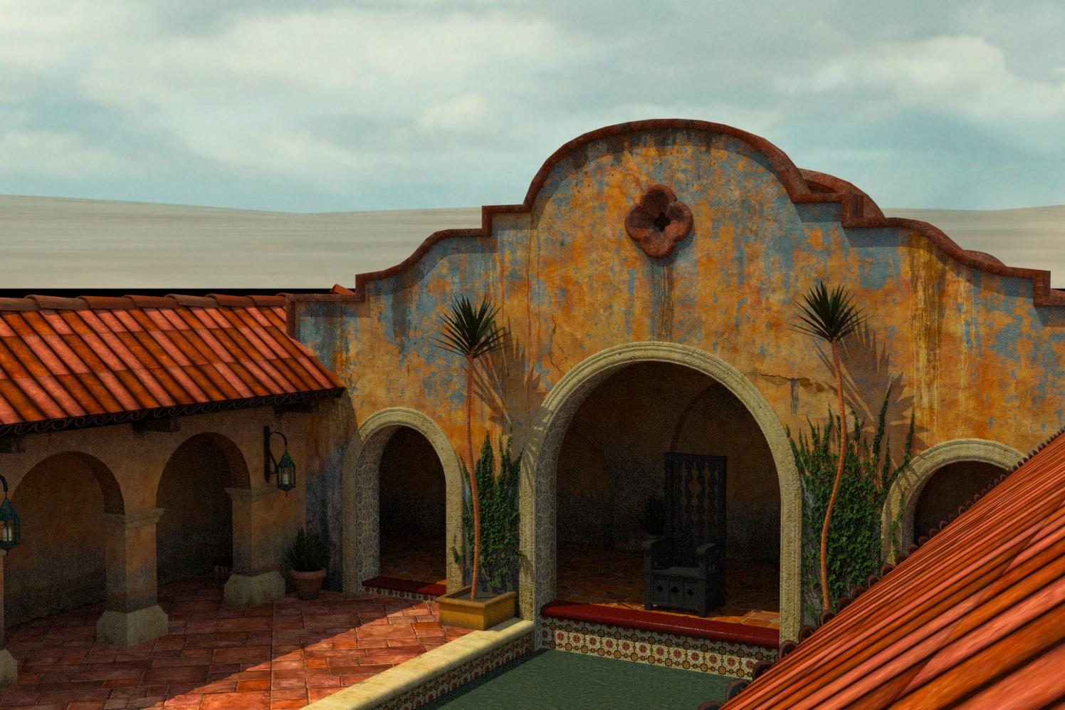

    This is the daylight one, 25 minutes and 111 iterations so a bit grainy. I'll try the night one next. I've also attached the skydome settings.
    Click on image for full size.

    This is straight out the box using one of the provided cameras. Everything is 3Delight but rendered in Iray. 91 iterations at 35 minutes and it is still showing 0%. CPU only :)

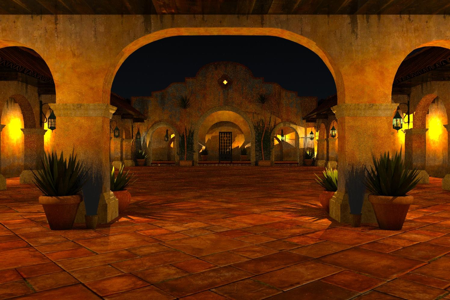

    The night shot again this time everything changed using the Iray Uber Shader. No stars though so that would need a bit more work. 40 minutes, 105 iterations and 23% done.

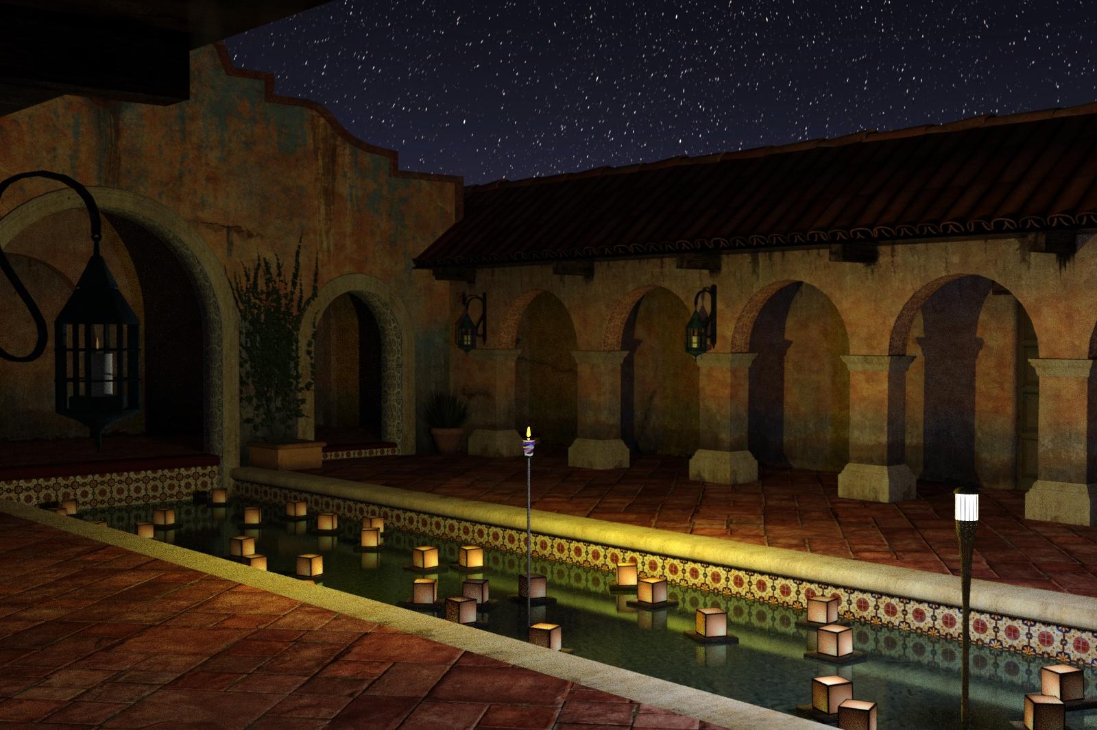

    Starry nights with the lights adjusted and its own skydome. The Iray Uber thing turns it into an emissive surface, so I just turned it down to 2 cdcdm*2 so that it was barely doing anything, which seems to be enough. The lantern point lights are still too bright, I think, but I can fix that later.
    Also another test render with the Labella Magica skydome from elsewhere.
    Both CPU renders, ran for about 10 minutes each. No idea wht the completion percentage was.

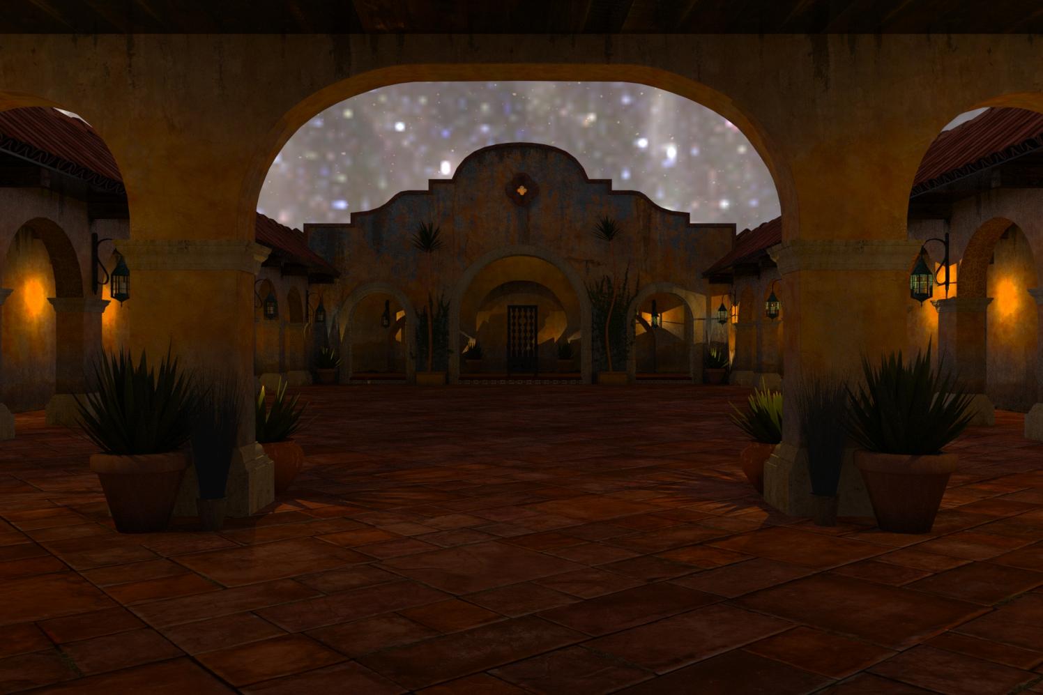

    I put a Milky Way HDRI in for stars in this one. The image was pin sharp so I don't know what Studio does to images when they are added to domes they all come out fuzzy. If I want fuzzy I can do that with DOF or haze, I wish they would fix it.

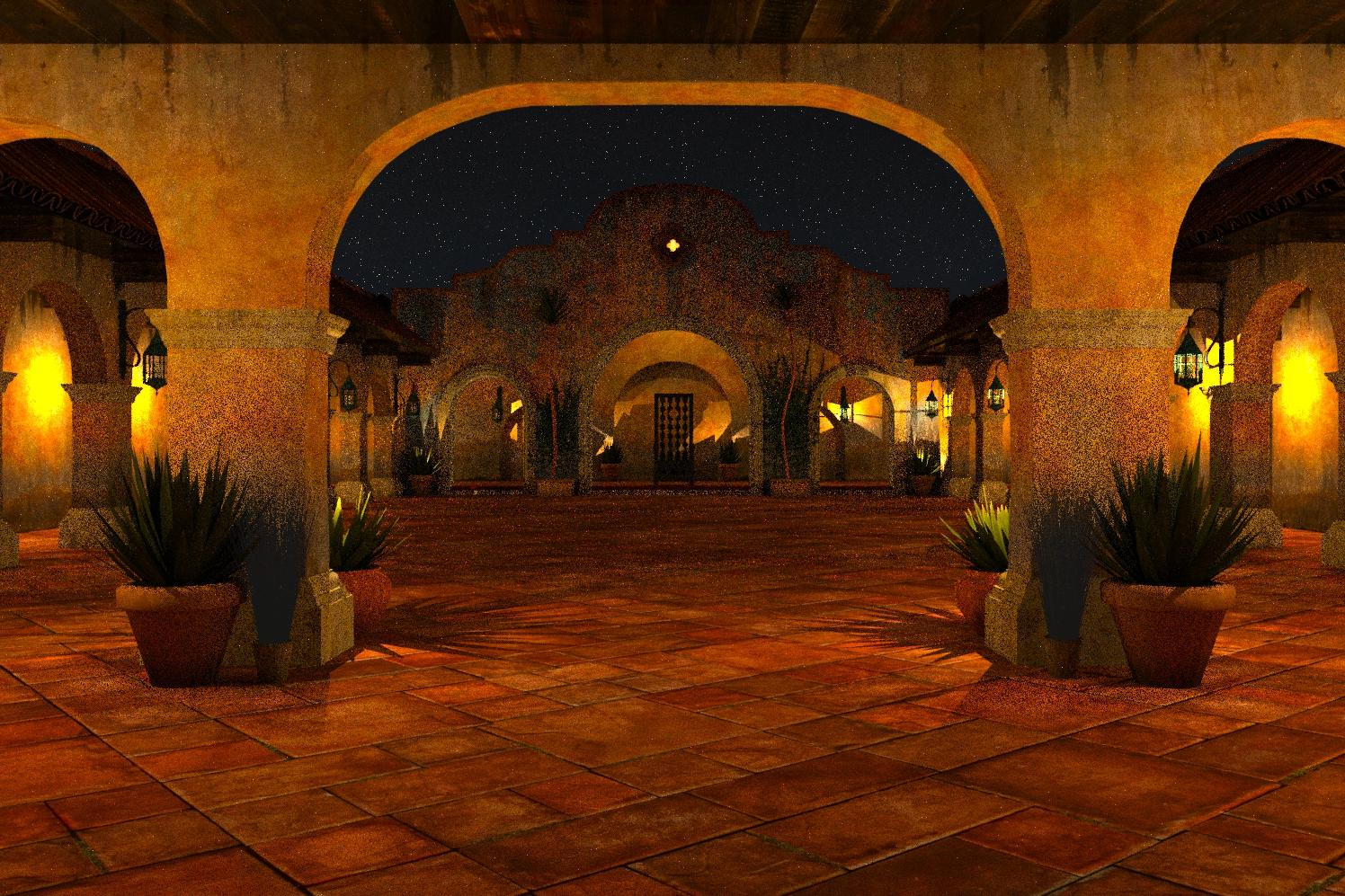

    need more light !!
    2 torches light luminence set to 300,000,000
    very Y ​lowered starry dome horizontal tiling = 10
