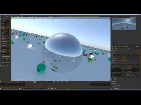

    3. Two different YouTube Tutorials
    (in Blender)
