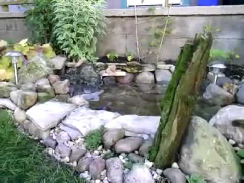

    I have been to a few places in the world including the High Arctic and to the Middle east, Germany, Bosnia, Afghanistan and of course the States they all have beautiful landscapes if you care to just look at it and appriciate what is there.
    ...and to live in it!!! For a good part of my career, I made really nice little natural-like playgrounds for songbirds - meant to attract them in for the home owners to see and enjoy. These things also attracted chipmunks and look really cool to humans.
    My phone cam resolution stinks, but this is the little Babbling Brook that I made for myself and my wife, which is actually a bit different than those playgrounds... but now, a few years later, it looks amazing!!! I need to get a camera and take some updated shots!
    Birds actually dive right into this and flap their wings in the shallow water. Many songbirds fear water that is too deep and/or too fast
    Post edited by Dartanbeck on

    ha ha yes your night is our day :) nice pond @Dart.
