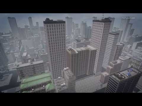

  • BrianP21361BrianP21361 Posts: 815
    edited July 2016
    I finally got back to trying Urban Sprawl 3 in Carrara and after incorporating most of what has been posted here I think I've got it all working. Here's a bunch of pictures and screen shots showing what I did.
    First I loaded the 3Delight version of Block 1. That's the first render. I used Frnric's Shader Doctor to clean up the shaders. It does a good job, but additional tweaking is necessary. That's the second render. You'll notice that some of the textures don't look right. That's because the uv's need to be fixed. Double click a building (or click on the wrench) to go into the modeling room. Select the whole building. I use command-A on a Mac. Select the UV editing mode by clicking on the icon in the top right hand corner. Untick Wrap U values. There's a screen shot showing this and the fourth rende is the result. The road still doesn't look right. A couple of things are needed to fix that. Edit the Roadtile textile. The screen shot shows what it looks like in the texture editor. The problem is that the U3Road3 image needs to be tiled. I used a 100x100. I haven't tried a close up render. You may have to play with the tiling to get it to look correct. It looked better, but the road was a little too light for me so I added multiply to the texture image and added a dark grey. The grey can be changed to get the road the right color. That's the fourth render. Now to get the white lines and the cross walks onto the road go to the RoadTile shader again. Go the Top Shader, use the drop down menu (showing Multi Channel) and change that to Complex Shader-> Multi Channel Mixer. The road texture should be in Source 1. I used a whate plastic for Source 2. Just drag it from the Shaders window at the bottom onto Source 2. Now for the Blender at the bottom choose Texture Map. Select u3RoadMask1A3dl for the teture. This worked for Block 1. You might need to try another one for other blocks. I haven't tried yet. I've included a screen shot of the entire shader tree. and the fifth render shows the lines in the correct places. For the Sixth render I added a second light, turned soft shadows on for the first light and also used ambient occlusion. It looks pretty good. I tried the same process starting with the Iray Block 1 and I think that looks a little better than the 3Delight one. Normally I use 3Delight versions in Carrara, but after doing this I'm going to have to do more experimenting. I'm also going to go back and adjust some shaders. Adding reflections to the windows make things look a bit more realistic. Hope this helps.
    I just added a close up higher resolution render. Still looks good.
