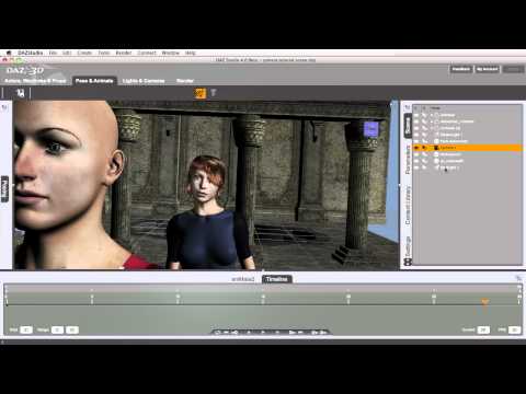

  • scorpioscorpio Posts: 8,533
    I usually add another camera to look at the DoF camera and it also helps if you make the guides on the DoF camera a bright colour.
    Select the DoF camera and go to the camera tab in the Display change the colour of the DoF, make sure the DoF is turned on in the Camera section.
    Looking through your second camera use the frame thing to get your Dof camera into view and then in the Camera tab in the Camera section you can use the Focal distance and F/Stop to get the Dof you want.
