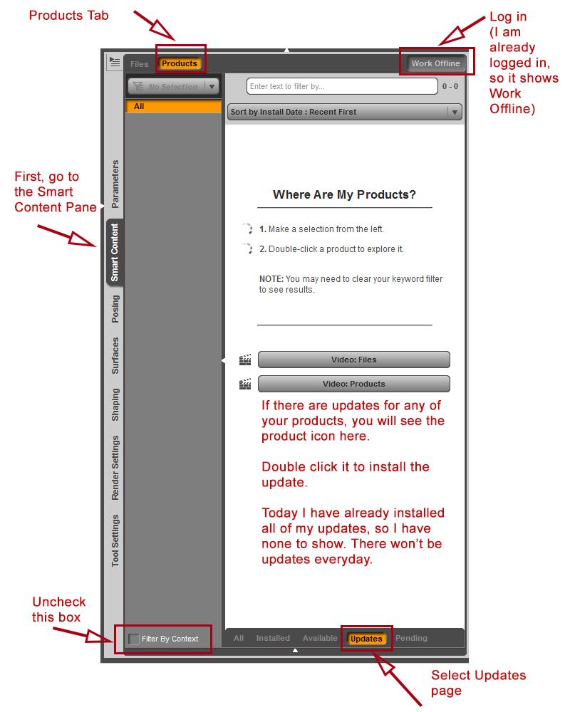

    Here is an illustration of how to find updates for your products in Daz Connect.
    800 x 1000 - 293K
