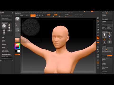

    Hi mjc1016. So, I if I understand correctly, I can export my g3f character to Zbrush and then make the mesh high resolution and then make my rib morphs. Then create a normal map in Zbrush which I can then apply to G3f back in DS. Is that the way it works? I have a lot of questions about this process, for example do I need to return the model to the original mesh resolution before creating the normal map? What is the procedure for making the normal map?
    Do you know of a tutorial that shows how to do this? Or can you make one?
    If this works then it sounds like making HD morphs for the g3f figure will be unnecessary. Are there limits to what can be done by this method?
    Yes, that's basically it, but because it's a map instead of a morph there are limits as to what can be done...like it doesn't change with poses...
    I use Blender so the process isn't the same...in Blender you can do a multi-res bake, so no you don't need the low poly mesh (you can also do a hi to low and for that one, yes you do need the low poly mesh).
    There's a ton of tutorials for zbrush around, but since I don't use it, I'm not sure what the good ones are...
    http://polycount.com/discussion/72460/zbrush-baking-normal-map-from-highpoly-to-lowpoly (this is a very basic rundown)
    There are several around here that do use zbrush this way and hopefully will chime in.
  • IsaacNewtonIsaacNewton Posts: 1,300
    edited April 2016
    I did a quick search on the internet and found an excellent, simple and to the point video tutorial by SickleYield called "Normal Maps Zbrush to Daz Studio Genesis 3 Female".
    SickleYield takes you through all the important steps in making a HD morph in Zbrush on g3f and then baking it into a set of normal maps (note Zbrush will export all the g3f normal maps at one mouse click).
    One important point. I noticed that under the menu Zplugin:Multi Map Exporter, SickleYield has the "vflip" option checked and when she shows the normal maps they are the correct way around (the ears on the face map are at the top). When I did that, I found that the normal maps were flipped vertically so the ears on the face map, for example, were at the bottom. When I unchecked the "vflip" option then Zbrush exported the normal maps the correct way up (ears at the top).
    I don't know if this is a version difference issue or if I, or SickleYield, have another parameter switch somewhere which is different and is overriding the normal map orientation. I did use the GoZ approach rather than importing g3f as an object separately from DS 4.9, so maybe this already takes into account that the normal maps have to be flipped.
    In any case this is an easy thing to check and change if necessary. Thanks SickleYield for a clear tutorial.
    Perhaps one other piece of advice; make the HD morphs which you intend to export as normal maps quite bold (i.e. relatively large normal extension, so it stands out from the surface). DS4.9 does give the option to vary the intensity of application of the normal map between 0% to 200% but I find the results at 100% rather subtle. If you do over do the morph, you can always turn the normal map intensity down.

    Yes GoZ will set to flip the maps for you. It's why you can export them without the vflip option.
  • SickleYieldSickleYield Posts: 7,649
    Yup.  I don't use GoZ so that's probably it.
