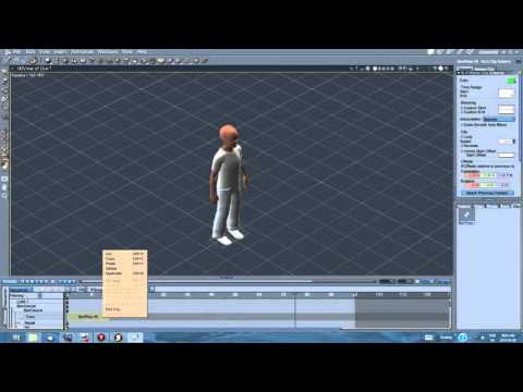

  • mmoirmmoir Posts: 821
    edited February 2016
    BC Rice,
      Here is the video, in Poser  I created a quick animation on a figure, saved the pose to the Pose library. I then load the Pose onto the Figure in Carrara several different ways,by clicking the Pose Icon and by using the Pose As Clip feature. I also create a Master clip for use later on.     Hopefully this helps you out.
    Post edited by mmoir on
  • BC RiceBC Rice Posts: 591
    mmoir said:
    BC Rice,
    Thanks a lot for taking the time to do this. So it looks like my issue is primarily that my files simply aren't showing up in my hierarchy anywhere in Carrara. In my Carrara files all of my animations are somewhere in my Aniblocks folder. But that folder doesn't appear inside Carrara despite the aniblocks folder being inside the Runtime "My Daz Content".
  • 3DAGE3DAGE Posts: 3,311
    Great video mike :)
    In poser,. when you save a single pose or an animation,. it'll create a little thumnail image (icon) for the pose or animation,.
    In carrara,. you can arr any poser folder wich contains a "runtime" folder,. and Carrara will display that folders runtime content just as Poser would,. EG: Figures / Hair / Poses / Props etc  So,. you can save your poses and animations in posers folder structure,. then jump into Carrara and see those same poses,.and apply them to th figure in the same way you would in Poser. double click to apply to the selected figure.
    It sounds like you just need to "add Folder" from the carrara browser,. and select the main folder which contains your poser runtime folder,.
    or,. as mike showed,. you can add a new folder to the carrara browser,.. whereever you save your poser poses.
    1438 x 961 - 287K
