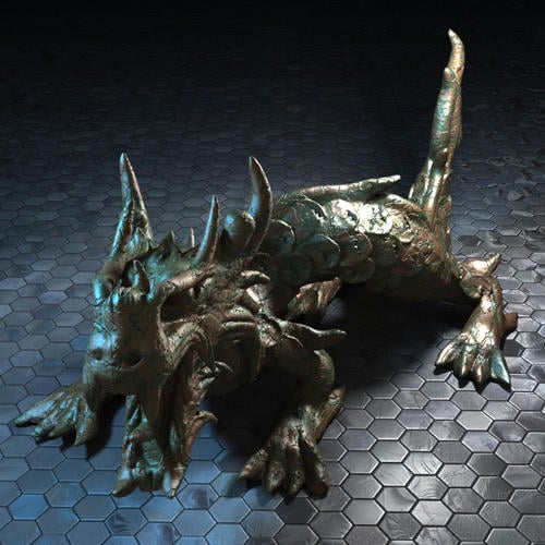

    Here the material on the dragon is a mixture of image based and procedural. The material on the ground is built up entirely of image based. To get a good bump map effect fairly high resolution sources are needed. You can check it out since I put this material up on the free material exchange. http://www.bryce5.com/details.php?image_id=4702&mode=search if you look at the remarks below the file you will also find more details regarding using images as textures.
