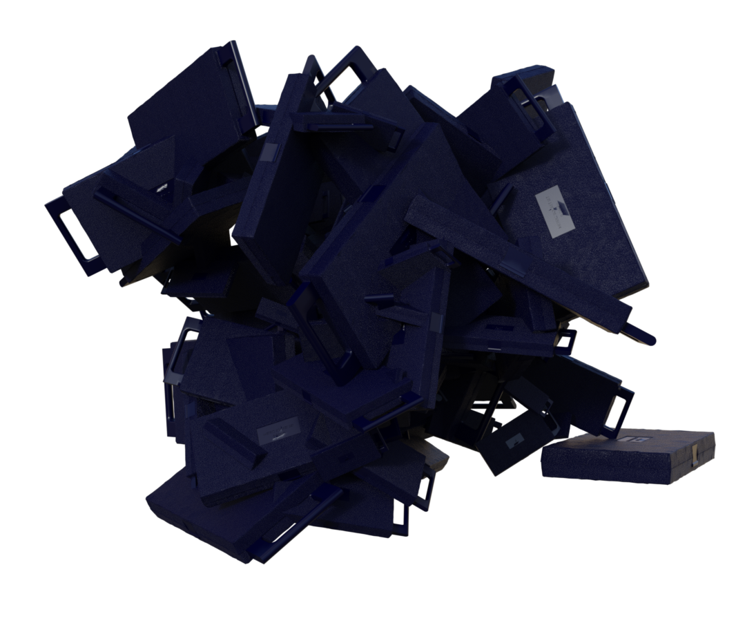

I'm developing a script to create swarms of instanced objects in a volume. I want to replicate swarms of objects in a rectangular bounding volume. The sort of thing I'm thinking of is a load of leaves blowing down wind of a tree, a swarm of butterflies/birds or an invasion of flying pixies, where they can be utterly random (leaves) or show an individual variation on a general orientation (flock of birds).
The Scripts are now available here:
Cuboid: https://www.daz3d.com/forums/discussion/comment/9230701/#Comment_9230701
Spheroidal/Elipsoidal: https://www.daz3d.com/forums/discussion/comment/9264326/#Comment_9264326
I have got the general randomness and limits working with my proof of concept script, but I need to make some efforts to try to prevent the instances from intersecting with each other. The proof of concept output from the script is shown below with a socket set box and 100 instances in a 50cm cube volume. The instances have random scale, position and orientation in 3 axes. The random values for the rotation and scale are all user specified between upper and lower limits. It's a tiny bit intimidating initially as 14 limits and the number of instances need to be specified, but I'll write a help file to explain (if I eventually reckon it is in state to release on an unsuspecting public.
I hope I can develop this into a useful idea. Can anyone think of uses you might have for a little script like this, or am I doing it just for myself? That latter option wouldn't be the first time.. ;)

    I have finally got to the point of a working Cuboid Swarm Script with basic collision detection that does the job I originally wanted it for. It fills a user defined volume with instances of the original model, randomly positioned, randomly scaled (within user defined limits) and at various angles (within user defined limits again).
    It's suitable for wind blown leaves, butterflies, dragonflies, shoal of fish, that sort of thing. The picture below shows how it works with a single one facet green leaf model instanced 2000 times in an 8 cubic metre volume (2*2*2m) then a second set with another 2000 brown leaves was off to the right. The window in the image shows the inputs.
    The instances are all tidied up into an instance group, which may be translated, rotated or scaled as one object without needing to deal with the individual instances. The same seed object may be used for many different Cuboid Swarms.  Swarms of different objects can overlap, but the basic collision prevention only happens during generation inside a swarm between members of the swarm.
    There is a programmed limit of 10,000 in a group. You can select a character's root node, and instance all clothing etc up to 10,000 times. It will take a long time and I will not vouch for your machine's stability if you do it.
    I leave you to imagine whether it's useful for you, but I hope it is.
    Regards,
    Richard

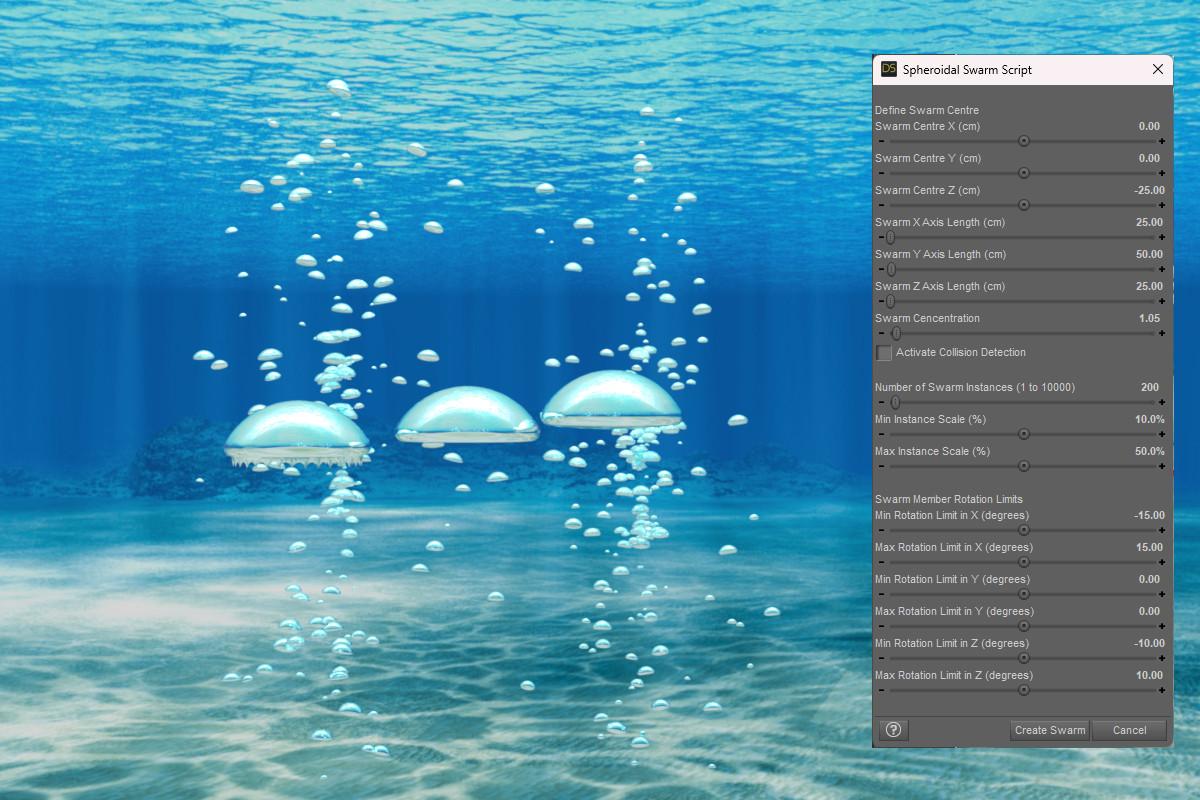

    Now, I have created a script that produces a result a bit more like a swarm of insects clumped around a Queen, or a spheroidal swarm of bubbles around a swimmer.
    You can switch the clumping on or off, and because collision detection causes fewer instances to be generated in the middle, it too can be turned off.
    Anyway, have fun with it.
    Regards,
    Richard

    I was a bit concerned about the strength of the concentration of instances to the middle, and came up with a script change that allows the user to select the level of concentration to the middle.
    1=No concentration
    2=Previous concentration level
    3=Yikes.
    The image below shows a concentration of 1.1 on the left and 1.05 on the right.
    Anyway, I offer the script as an alternative.
    Regards,
    Richard
