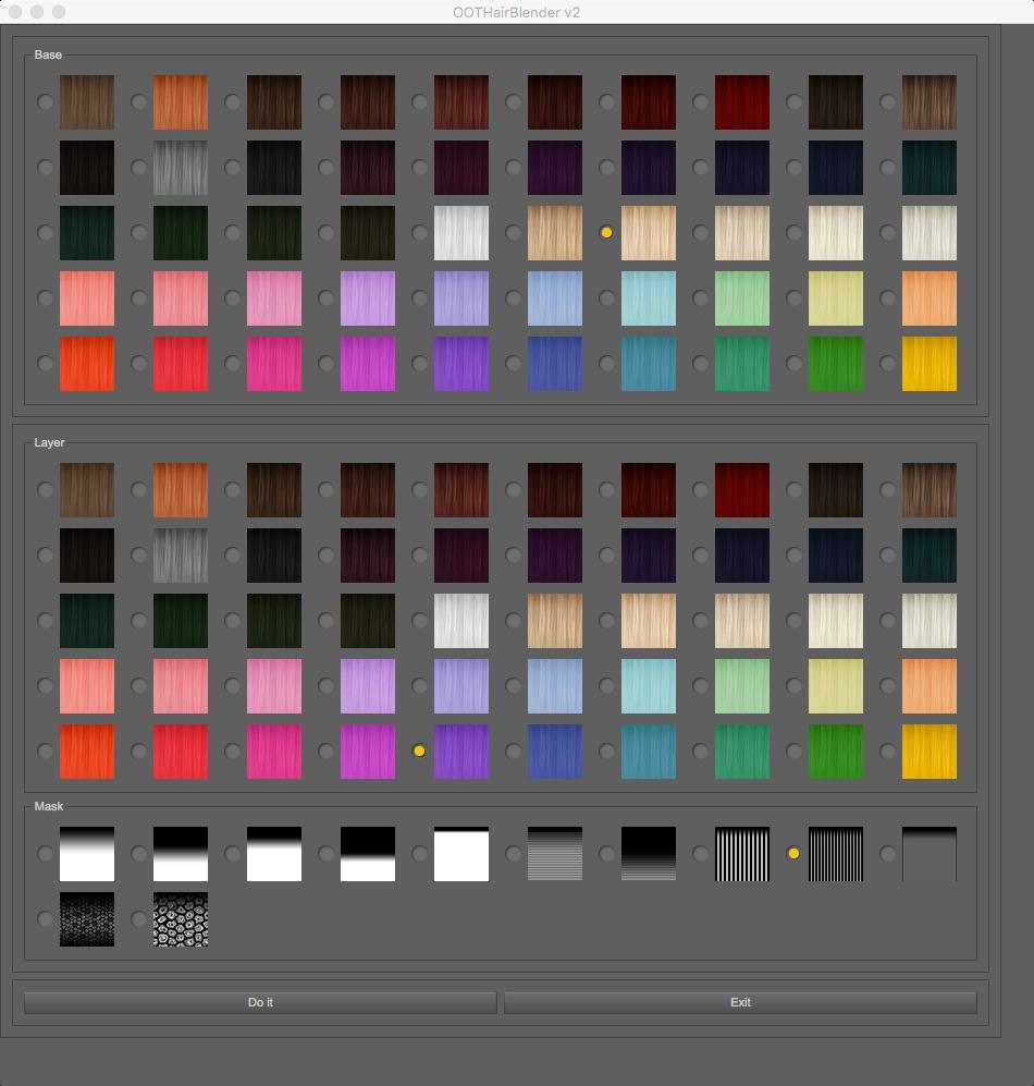

I'm finally getting around to releasing this. Hopefully others will find it useful. Download it from here and just merge it into your library.
From the README:
Outoftouch has produced a number of hair props for Poser/DAZ Studio that include a "HairBlending" feature.
As released, this feature is automated only in Poser Python. This script reimplements that functionality in
DAZScript.
HairBlending works on any hair with a vertically oriented UV and straight strips. Simply select all the hair
materials in the Surfaces tab that you wish to blend, then launch the script. Choose, from top to bottom,
a "Base", a "Layer", and a "Mask", then *Do It*. HairBlending will use the L.I.E. to create your hair texture.
The script, and OOT Hair Blending in general, should be renderer agnostic as it only edits the diffuse channel.
NOTE: Outoftouch has graciously allowed me to release icon versions of the hair textures used for hairblending.

    The lower part is unreachable, the window is too "long"...
    Hmmm. I'd have to make it two columns wider to make it any shorter (or reduce the icon size). What's your monitor resolution?
  • ImagoImago Posts: 5,777
    Esemwy said:
    1366x768
    Pretty small, I know...

  • EsemwyEsemwy Posts: 578
    mjc1016 said:
    Esemwy said:
    Or add scrolling...
    Yeah. I looked at that, and will again. GUI programming isn't really my thing. Maybe this weekend.

    OK, scrolling works well enough that it'll fit within that 1366x768 monitor. If anyone has a better solution, please speak up.
    Perhaps it is a path problem.  Is "C:/!3D Content/Non DAZ3D" set as one of of your "DAZ Studio Formats" content paths and have you installed the icons in "Runtime/Textures/Esemwy/HairBlending"? In addition, it looks for OOTs textures in "Runtime/Textures/outoftouch/!hair" using the content manager. It's possible it behaves a bit differently on Windows.
    I'm running 4.9 as well, and even when I don't have anything else installed properly, I still get a dialog even though it's missing all the icons.
    If you right click on the script and select "Open in Script IDE...", is it 206 lines long and ends in "main();" ?
    If you select File->Run [Continue] Script..., does it still behave the same?
    If this doesn't get us anywhere, I'll send you a version of the script with more extensive logging, and we'll go from there.
  • NadinoNadino Posts: 258
    Yes that directory is set as both DS Formats and PS Formats - contains products from Rendo. I also have your product saved to the same directory.
    I do get the nice dialog when I click the script - I'm able to select from the 3 categories but when I select the "Do It" button it goes away and does nothing. The diffuse textures remain the same. It does remember my previous selections though when I restart the script.
    I'm showing the script as 206 lines with the last line being the main();   - Running through the Script IDE does the same thing.
    OK, I suspect it's not finding the actual texture directory, but regardless, I added a bunch more logging and error checking. Download the new version here.
