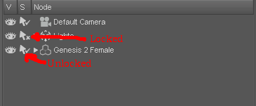

    Works for me...
    Are you sure that what you are trying to select hasn't been 'locked' so it can't be selected, other than through the scene tree?  If it is locked, there will be a little 'x' next to the eye in the scene tree.

  • No, that was the first thing I checked.  No dice.  I don't know why it has suddenly stopped working.  I have even just loaded a new item and tried to delete immediately and it won't delete with the delete key.  If it is just me, I may have to try uninstalling and reinstalling to see if that fixes it.  I know it the delete key itself isn't having problems because I checked and it works in every other program I've tried it in to see if it was a keyboard issue and that doesn't seem to be the problem.
