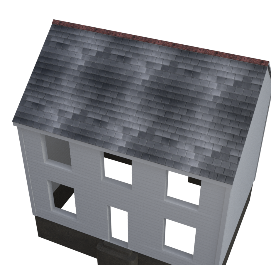

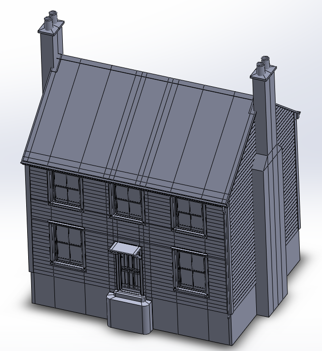

I have been modelling up a little house (as below) and have run into a little problem.
The roof slate texture I'm using is a seamless tilable one and needs to be tiled to get it to have the right size slates. However this leads to a noticable repeating shaded pattern. As below:
Now, I can darken the repeating image, but then my ham fistedness while altering the shading will also repeat. Not good. I thought 'Wouldn't it be nice if I could take the tile and repeat it lots and create a single tex map that will do the job' and then that image can be edited to avoid some of the pitfalls of tiled textures...

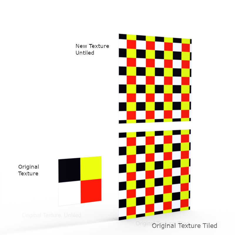

So, imagine a tile with four colours, repeated 4 times along the U axis, offset 0.1, and 5 times in the V axis, offset by 0.2. This is possible manually, but a pain. The sort of thing I'm talking about is this:

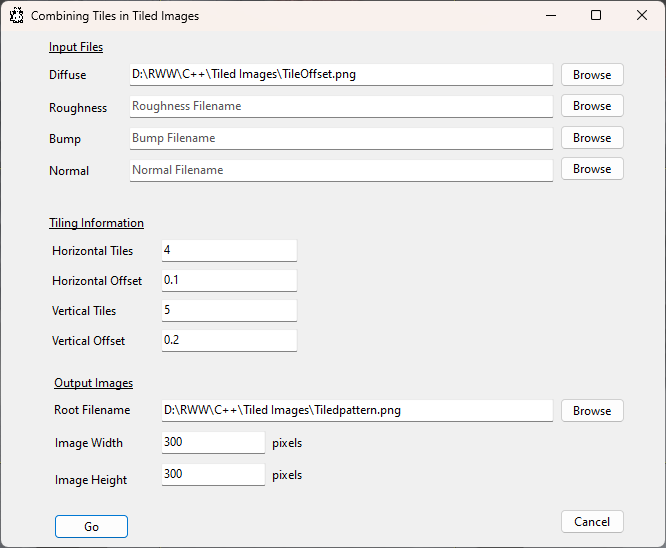

Combining multiple tiles by hand into a single image in an image editor is a pain, so a program would be useful for this. If you think so too, well..., I've just done one for myself under windows (32bit, used under Win 11), as below:
This currently has slots for Diffuse, Bump, Normal & Roughness. Would anyone find it useful? If so, I'll try doing a help file & could add channels like glossiness, emissivity etc (all but one of which could be blank when not needed) so those channels can also be done at the same time. If you want it & can think of extra channels, please say what you want & I'll add them.
At the moment the program can produce four files automatically, using the example above they'd be called
All the output files are always PNG and all are the same size as each other and the size specified in the program bottom two edit boxes (in this case 300x300).
