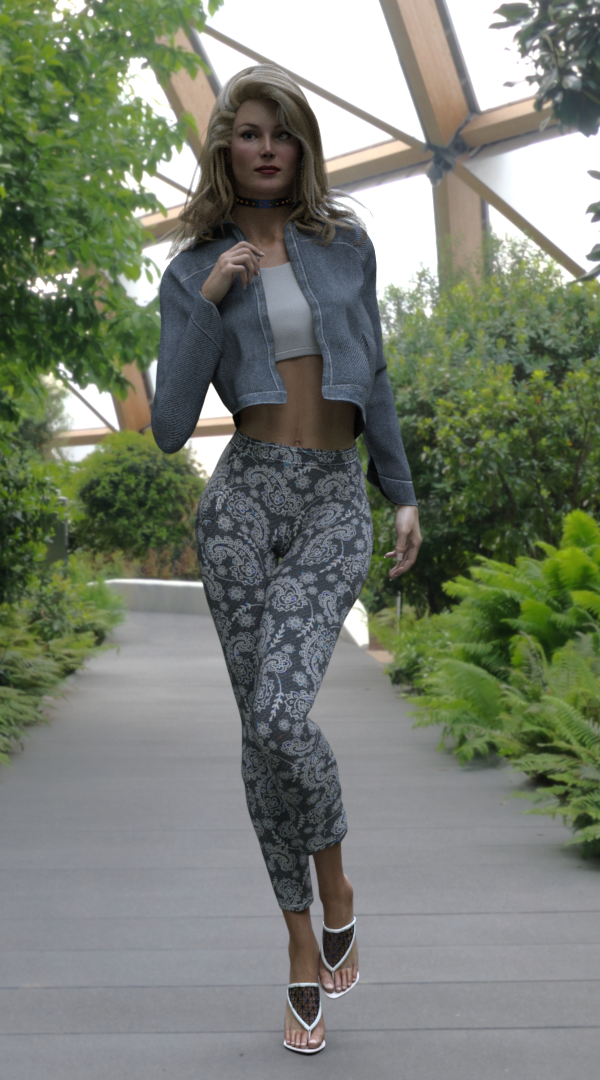

    Just an image to show a V3 based character wearing G8F Clothing (Denim Diva) that follows the character morphs. I'm tickled pink.
    Regards,
    Richard

    Nice!!
    You do know you can enter parameters/edit mode and select all morphs in one go (drag with the mouse or command-click), then right-click or in the parameters menu set auto-follow ON?!
