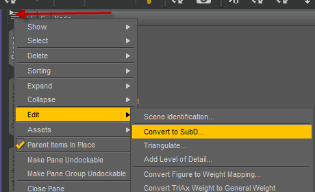

    I'm not quite sure to understand but I guess you imported a model from sketchup to DS and want to know how to smooth it when rendering?
    Try this :
    Go to scene tab and select your bowl then click on the scene tab option then Edit->convert to subD
    Go to the parameter tab then on your Bowl if it's not already selected then go to Mesh resolution. There you can adjust the subdivision of the mesh. The more subdivided, the more smoothed it will look but don't go too far too. The limit by default is 2 but you can edit the limit
    I don't know for poser but there should be some options for subdivision too like any other 3D program
