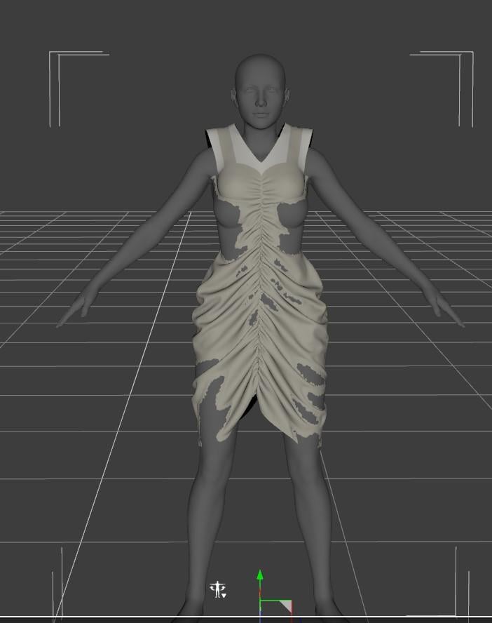

Hello~! Just as the title says when I import an item I created or a default Marvelous Designer outfit into Daz as an obj it fits the gen 8 model in her default pose. However when I go to transfer utility the outfit stays fine up until the 100% point when it hits weight mapping and the garment rises several inches. I'm not sure how to fix this and help would be greatly appreciated.

  • lilweeplilweep Posts: 2,864
    is that actually the default Gen 8 shape? If it's not the default shape then choose the option in Transfer Utility to 'Reverse source shape' or some such
  • sunnyjeisunnyjei Posts: 502
    This is the shape after applying/using transfer utility. Before using it the dress fit perfectly (or at least appeared to but of course when I posed the figure the dress didn't move too). The avatar is an imported gen 8 in MD so I think the error is happening during transfer utility or with the obj import/export but I followed 3 different guides that had almost exactly the same settings that I used.
  • felisfelis Posts: 6,502
    What lilweep refered to was that if the character is not the base character, you need to tick 'reverse source shape from target'.
    Transfer utility will default assume it is modelled towards the base charcter.
    edited February 2023
    Thank you. I used the default gray to get around the nudity issue because of how the dress fits after the transfer utility. But it fits exactly the same on the model I used to export to MD. Is there any way to fix it? Dforce just exploded. Hexagon (to be fair I don't know hex) made a morph that didn't really help either frown
    I am in doubt of what you are asking.
    First you said that transfer utility moved your clothing upwards, and we said to fix it in the transfer rigging settings. Is that fixed?
    Now you are talking about dForce explosions. Is that simulated in a pose or in the default pose? If in default pose, either the mesh is too dense, or there is something clipping before start of simulation. If for posing, you have to make sur that there isn't limbs intersecting each other on the way to the pose, and thereby trapping the clothing.
    Thank you! I thought by using the character both in MD and Daz it was the default and at first when I used Transfer Utility it wouldn't let me check the 'reverse source shape from target' but when I went and changed the other settings under Item Shape to 'current' for both the Scene Item source and target- it worked! (I mentioned dforce before because that was one way I had tried to fix it but it exploded). Again thank you both!
