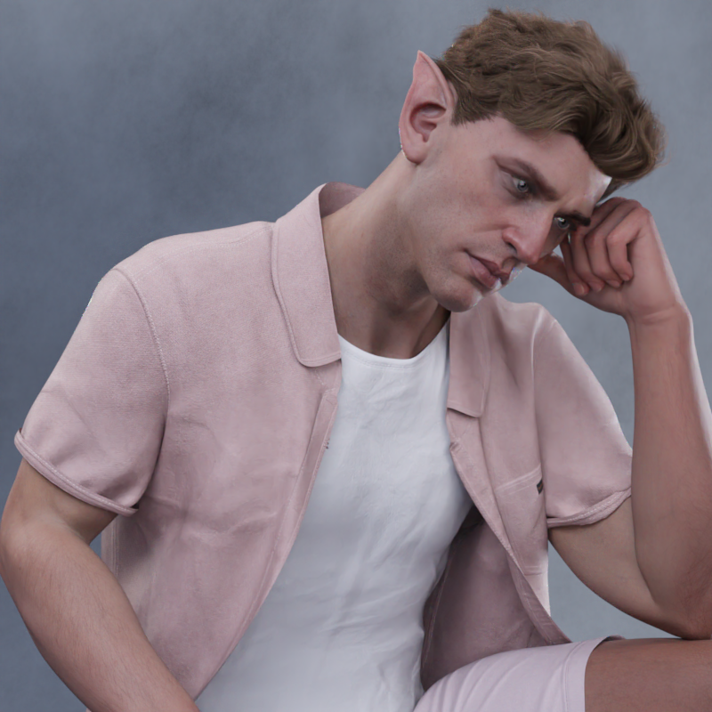

    Torian 8.1 and everything on him is for Genesis 9. I made a clone. Instructions in the Freebie forum. It's pretty easy. If I can do it, anyone can ;). The only thing you need to be aware of is that dforce strand based hair will not fit correctly, even with a clone. Not sure why, but it is what it is. Polygonal hair fits well though, as you can see :) And yes, as other have mentioned using autofit is the easiest, but it will destroy custom bones :(
    800 x 800 - 840K
    Post edited by AllenArt on
    That reminds me of Fred Gwynne (Herman Munster) which I didn't notice on the original Torian 8.1 page.
