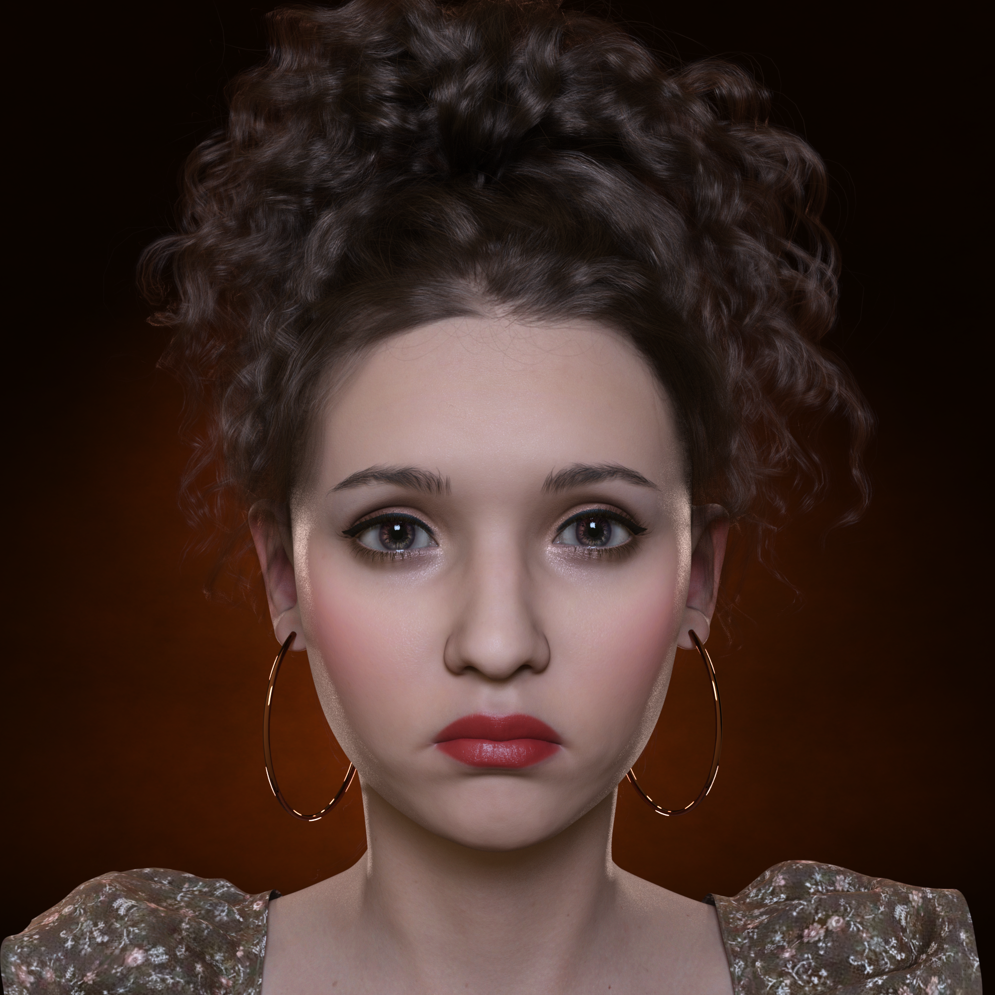

    Eh. Here's my render of her with the V9 makeup set foundation on.
    745 x 873 - 401K

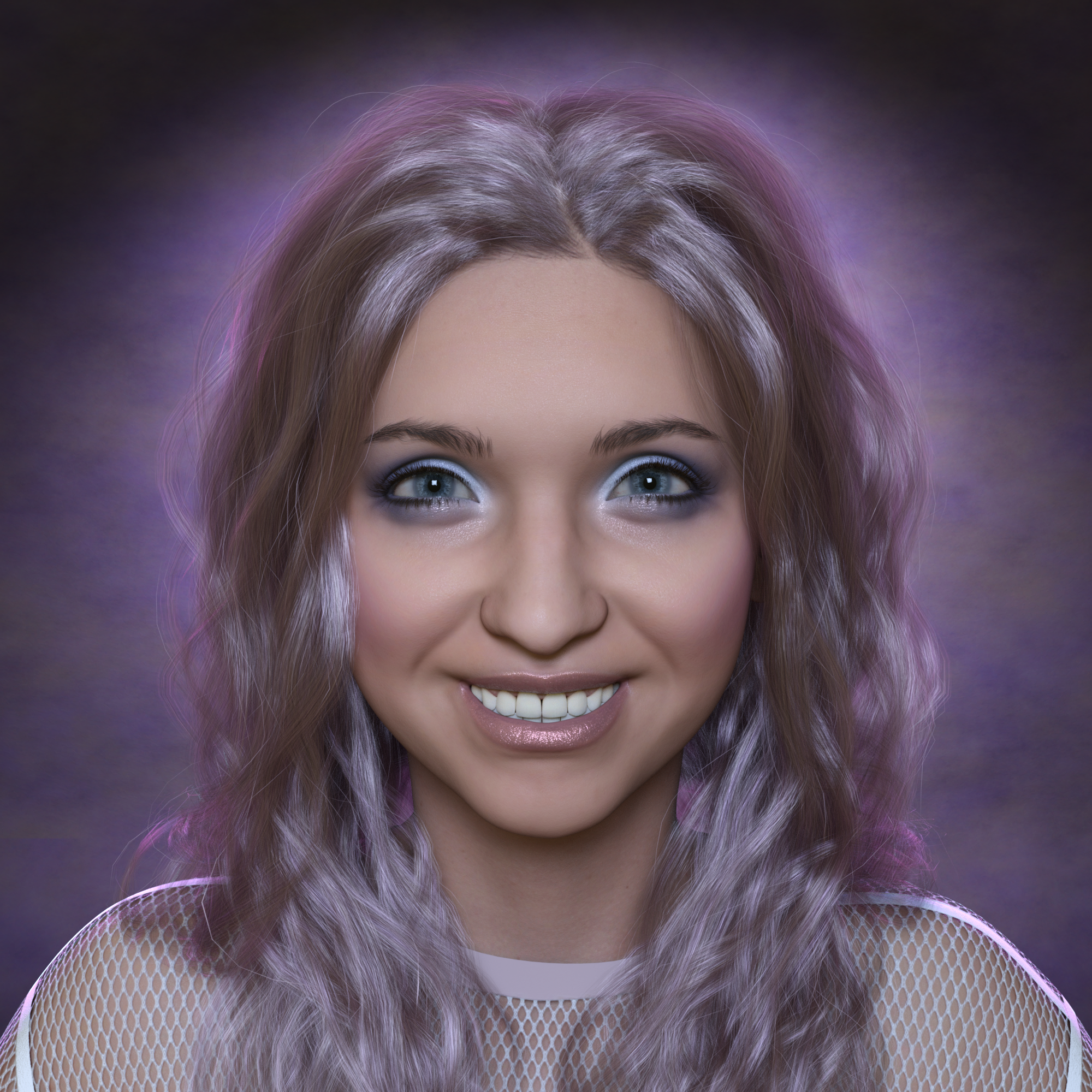

    How to get Victoria 9 HD Makeup to work on Genesis 9
    These are all Genesis 9 (not Victoria 9) with the free skin mats.
    As you can see the Victoria 9 Makeup works but it does require loading in a certain way.
    - Be in the iray preview window and load genesis 9 with any of the materials.
    - Apply any of makeup sets (use the apply all preset) and wait for it to load (it will look odd at this stage)
    - Hit the iray preview again (it may still look odd)
    - Now hit the remove all preset and the makeup should now look good (don't hit the iray preview again or the makeup will be removed)
    3 of the 5 sets have a foundation that is designed for pale skin so even though they will work on dark skin they would look odd - although single elements contained within the set may work ok.

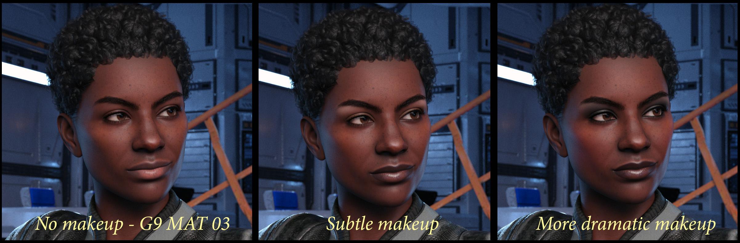

    Thank you for sharing this option! I was waiting to see how the V9 Makeup was and this thread made me worried about purchasing it. I was able to test the set you mentioned today and it worked out pretty well on darker skins. I did find a few issues with the colors on the lips, but there were options that worked well and you can change the strength on them from .01 - .07. If anyone wants to see the results on the LIE makeup on a dark skin, check out:
    Different makeup options
    (it uses one of the default G9 skins)
    Also, thank you for posting samples @SolitarySandpiper.  I'm a bit worried about your comment about not using Iray preview again since I do that a lot when working on an image, but the samples you posted help those of us curious on how the make up looks on G9. I also worry about the extra steps to get them to work. Maybe that will improve over time or once some LIE makeup options will be available in the Daz Store?

    Works ok with Bluejaunte's Stella
