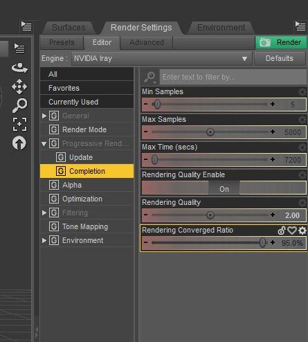

  • TottallouTottallou Posts: 555
    edited May 2016
    Here is a screen shot of where you need to do changes
    445 x 494 - 41K
    Post edited by Tottallou on

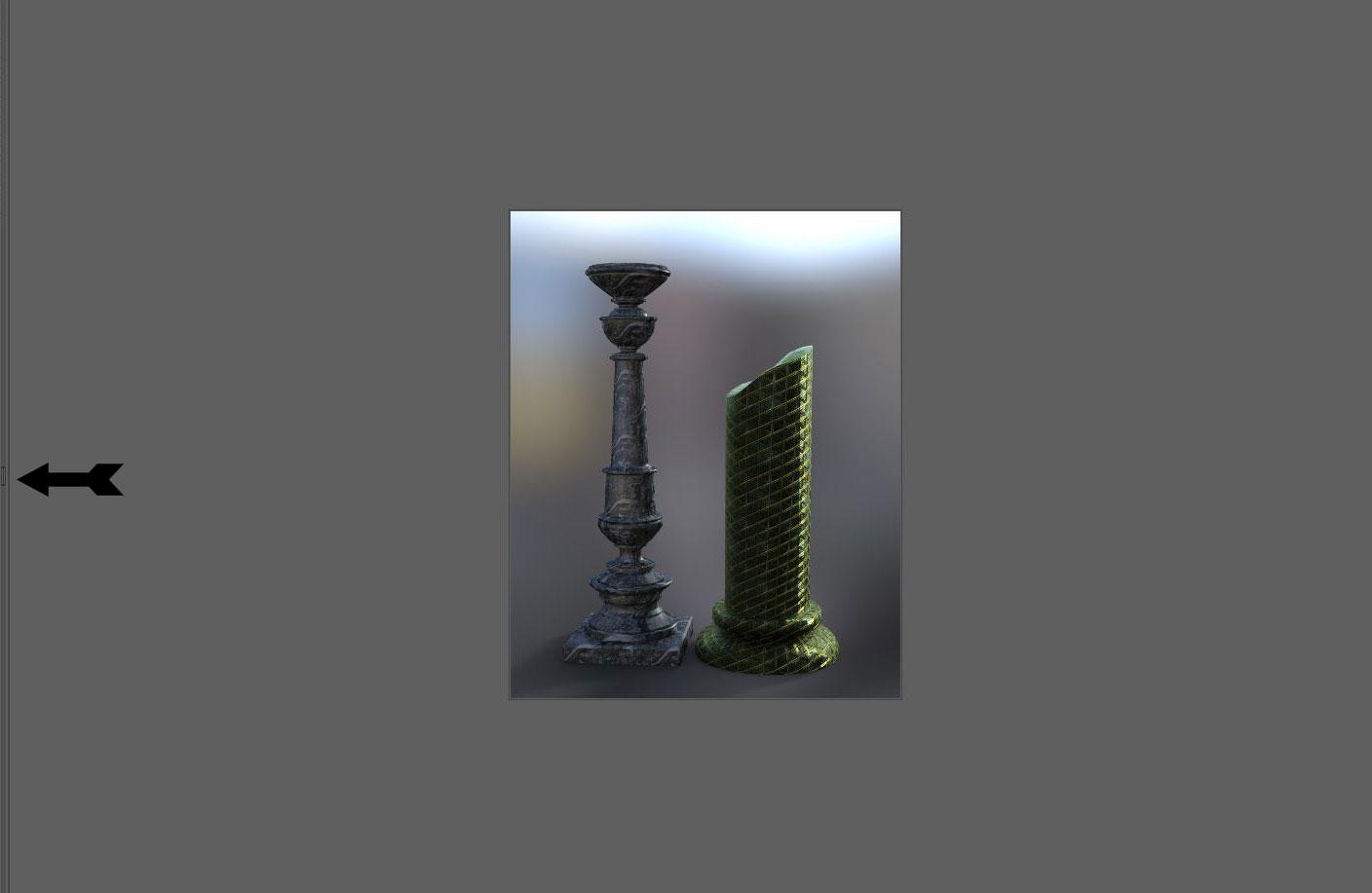

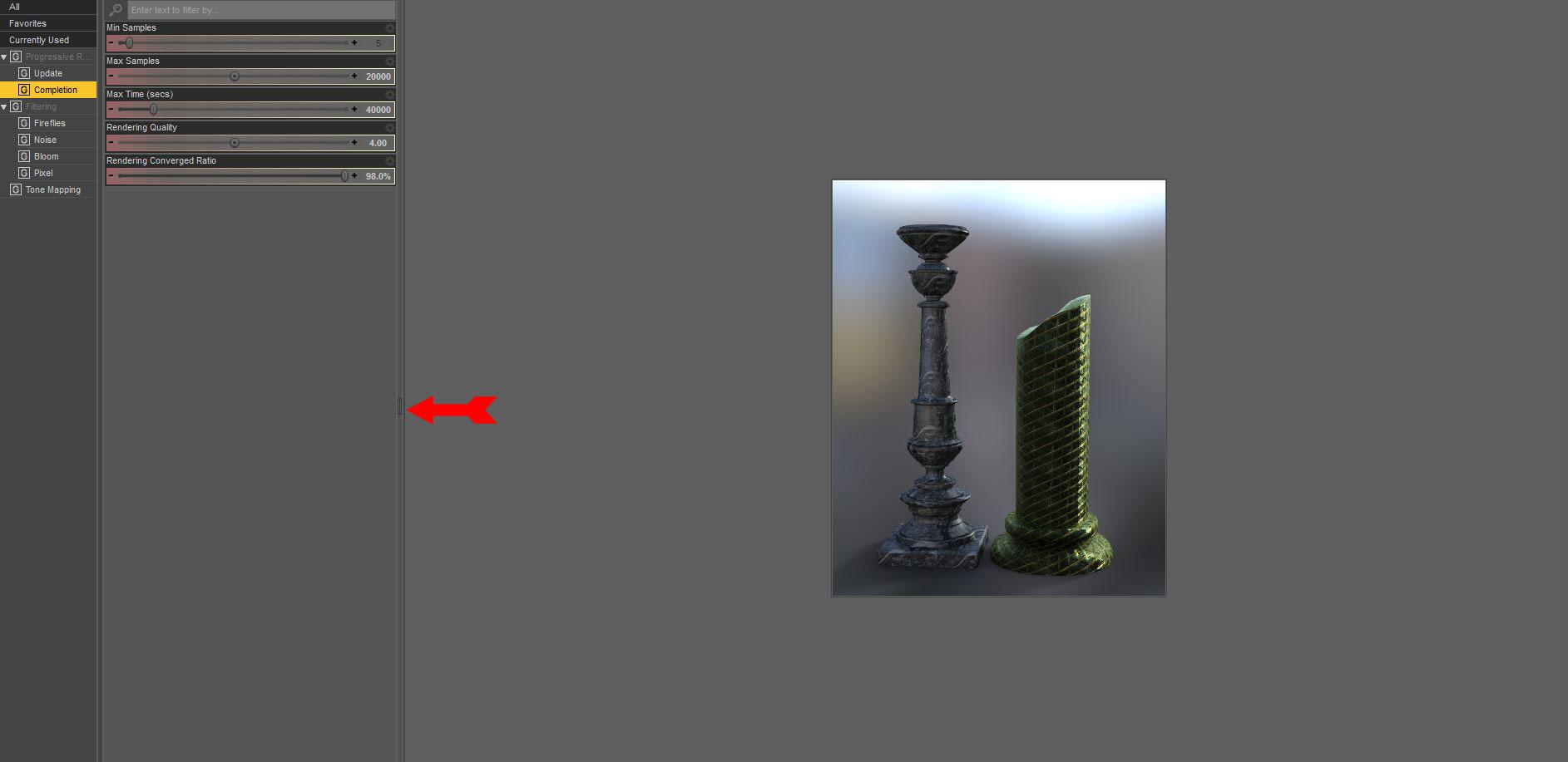

    edited May 2016
    I don't have that set but it should work with other things - (The one in Render Studio does).
    You can also change the completion requirements while you are rendering just click on cancel (Don't close the render window)
    On the left you can click to open a panel with your settings & up them if you think your render is not complete & it will continue or restart if it finished early  - I attached screen shots of that to as its easier to see what I mean - I use 4.9 but 4.8 has this to
    The 2 versions work much the same for render settings so you should be OK - 7 hours for a render makes you a lot more patient than me :)

  • Ken OBanionKen OBanion Posts: 1,455
    Every time I've encountered this issue, it's because I forgot to make changes in the Progressive Render group (above).  When I do remember (or am reminded by a recurrence of this very situation), I always set the 'Max Samples' to its upper limit (15000 on my machine), and the 'Max Time' value to some utterly insane number (115,000-and-change, usually), and then cut 'er loose!  (And then I take off for a weekend in Aruba while I wait for the render to complete!  I'm a huge fan of multi-tasking! wink)
    I generally leave the Convergence value at its default; I've never encountered any situation that would cause me to want to change it, and on those occasions when I did (experimenting, you know), I found that I would have been better off if I hadn't.
  • ToborTobor Posts: 2,300
    ^^^^ Ken has it right.
    To deal with stubborn grain, avoiding alter the converged ratio (95% is good for just about everything), but the Rendering Quality. The latter is a threshold of how Iray interprets convergence. The higher this value, the more strict Iray is in intepreting when  convergence has been achieved. It's a more controllable metric, and lets you set values above or below the baseline of 1.0.
    Converged Ratio is a termination setting, whereas Rendering Quality actually affects how much work Iray will put into making those pesky pixels look good.
    From the Iray programmer's manual: "A convergence estimate for a pixel has to reach a certain threshold before a pixel is considered converged. This attribute is a relative quality factor for this threshold. A higher quality setting asks for better converged pixels, which means a longer rendering time. Render times will change roughly linearly with the given value, i.e., doubling the quality roughly doubles the render time"
