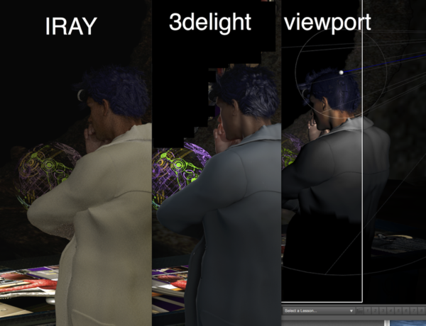

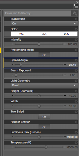

I've been googling and searching and I'm not finding answers.
I can't get spotlights to work in IRAY as spotlights....
they do some illumination, but they're not...shafts of bright light hitting something, casting shadows..spotlightly
In the picture below, you see the 3 things..the spotlight in viewpoint, hitting the back of the head in 3delight, and not really anything in iray.
(It's the best example I can give at the moment from this scene).
I've tried a lot of settings..different geometries -- i thought "column" then after reading a thread here, I went back to the default of point.
higher lumens....it defualted to 1500...I went to 2000...should I do more? less?
(I ALSO can't get the light sphere in front of him to emit light...I set it to immision, put the diffuse map in the emission color slot and base color, the opacity map in the cutout field . It pretty much just goes all white (with the cutouts). Should "emission color" besides the map be black or white? If it multiplies, it should be white, but that for sure goes all white, rather than the colors.)
1500 x 1149 - 2M

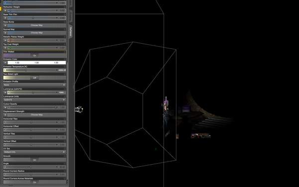

  • ScavengerScavenger Posts: 2,674
    I would change your units to kcd/m^2. (That's kilo candelas per square meter.) It takes a LOT of lumens to light a scene (hundreds of thousands to millions, unless the light is right up a character's nose).
    I don't see that as an option.
    (BTW SY, I've been using your quickstart tutorial to get this far...SO MUCH BETTER results and feelings about iray using THAT when I was purely fiddling around on my own, so thanks)
    305 x 606 - 47K

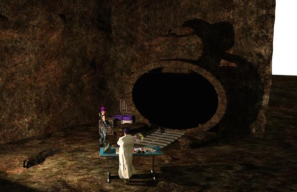

    Is there a way to use a mesh light to do what I want? like I said, it's a spotlight that illuminates the back of the person it hits and casts a shadow on the ground.
    Here's another part of the pic using the same spotlight (duplicate) in 3delight, casting the shadow.
    Edit: forgot the pic again..sigh
    490 x 305 - 193K
    Post edited by Scavenger on

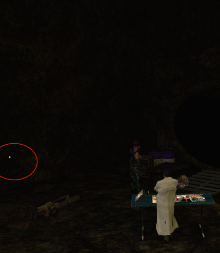

    Ok there's 2 attempts, with it at 90degrees and -90degrees. I'm guessing the one with the red circle surrounding the white square is facing away..it's a bit darker...and I guess the white square is the light?
    (sorry the pics are so small..couldn't get the forum to accept them)
    1000 x 1150 - 1M
    1000 x 1160 - 1M
    1599 x 1003 - 211K
  • SickleYieldSickleYield Posts: 7,649
    I can't tell from those where you've put the mesh light.
    edited June 2015
    in the top pic..the viewport, it's the white square on the far left next to the spotlight.
    ok, this one has it at 9,999,000 .. so that's too bright..or at least spreads too wide....can it be narrowed?.. the plane was a 1ft plane, reduced to 10%
    1700 x 1100 - 569K
  • DustRiderDustRider Posts: 2,904
    I'm just guessing from looking at the pictures you posted, but did you turn on photo-metrics for your spot light in the parameters tab and increase the "Luminous Flux" to at least 50,000 (a much larger value may be required, 50,000 works well for a low intensity rim light). I attached a screen grab of the the parameters tab, the last two settings control the brightness and intensity of the photo-metric spot light.

    I did do photometric, but didn't go that high..I'll give it a try...assuming i don't get another mega crash :/
    EDIT: Yep, mega crash...I can do about 4 or 5 renders before I get a crash that just takes down the computer...I don't know if there's a cache on the video card that gets filled and not emptied or what...but that's for another thread..
    BUT bumping up the spotlights to 50,000 did. Why does Daz default the spotlight to 1500..... I mean, I have access to smart people like here, but someone setting up a spotlight should get a spotlight...not a ..bulb.

    Glad to hear it worked! Definitely the default starting value is way too low.
    With regard to your crashes - are you closing your renders completely (render window)? Because of the way DS handles the data now that pausing/stopping and resuming Iray renders is possible, data is "cached" in both system and video RAM (even when the render is "completed" and the window isn't closed - because you can change the render settings in the open window and resume rendering). I was running out of RAM on my video card and defaulting to CPU rendering because I was leaving test renders open for reference. I use Open Hardware Monitor to watch my system resources and temps which helps a lot in understanding what is going on (http://openhardwaremonitor.org/).

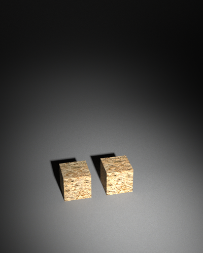

    I wonder if any of these would be helpful...
    http://www.seleconlight.com/index.php?option=com_content&view=article&id=475
    Well, yes, they just may help. I've got a Luxrender render cooking using PL1 20 DEG CW.IES from that link...it's a nice tight beam, great directional light and proper 'spot' falloff/behavior.
    I only let this cook for about 10 mins...
    (yes, it's Lux, but the behavior of the IES lights between it and Iray is very similar, once you get them set up...)
    819 x 1024 - 850K
    Post edited by mjc1016 on

    I noticed in your first screenshot of the light parameters on page one of this thread that the spotlight is set to Point. Point light is just that a point of light that emit spherically and not a spot.
    Mesh lights work differently in that the light rays get emitted in random angles and not perpendicular to the objects surface so they become less directional that a spotlight.
    From my readings on light geometry for photometerics, the different shapes control the different sharpness of shadows...the more area on a shape, like a sphere, being softer, and a point being sharpest.
    Is this incorrect?
