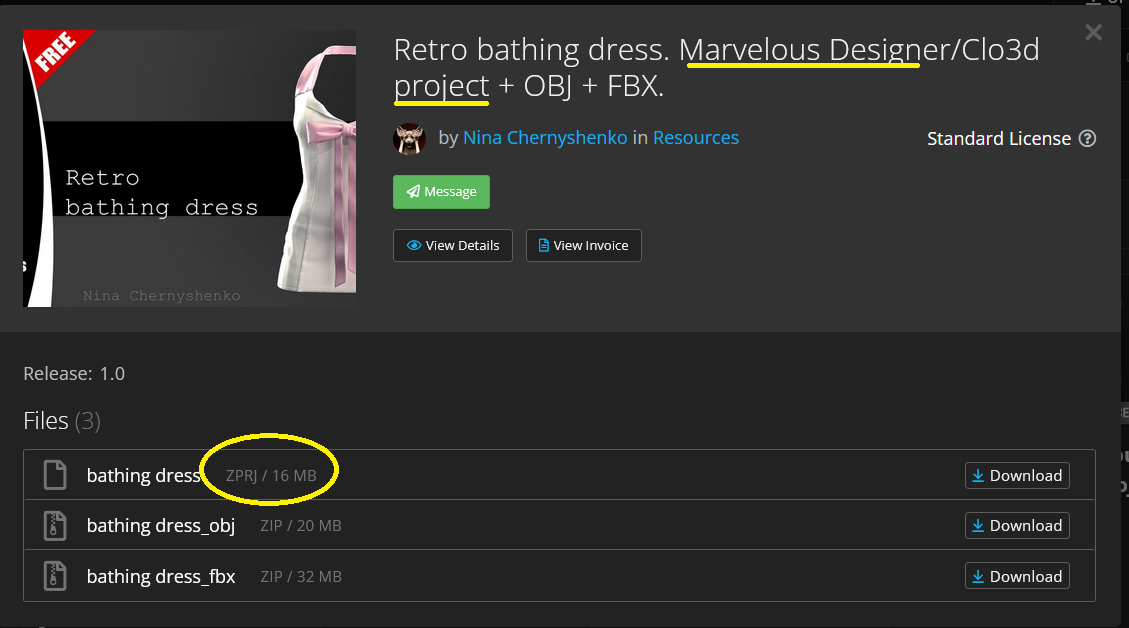

    Richard Haseltine said:
    I think ZPrj is ZBrush.
    ZPrj is the project file for Marvellous Designer. I've seen quite a few of them available over at ArtStation. I do not have MD ;-)

  • Richard HaseltineRichard Haseltine Posts: 111,635
    OK, thank you for checking.
    No problem.
