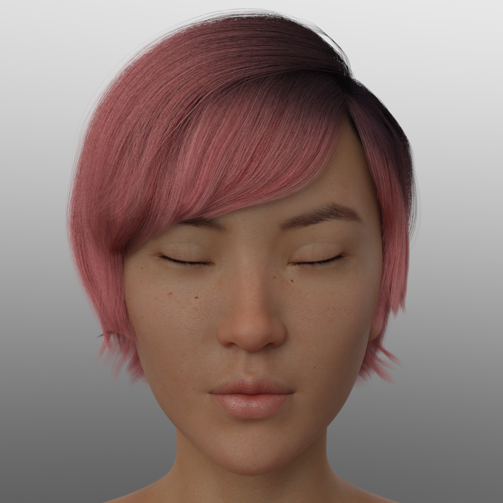

    Here is an example using https://www.daz3d.com/dforce-ingrid-hair-for-genesis-3-and-8-females
    Notice how the orange from Tip Transmission Color doesn't work with the Iray curves.  Also, you can see that the Iray curves are more smooth and the Daz curves are jagged and sharp.
    For the second test I used https://www.daz3d.com/dforce-speakeasy-hair-for-genesis-8-81-and-3-females
    The pink color is missing with the Iray curves and it is also missing the glossiness and shine.

    As for the colour shifts:
    The difference in color likely comes from root-to-tip blending and the difference between UV orientation of the curves/fibers (X) vs the default UV orientation of tessellation (Y). This can be accounted for by importing the (Blended Dual Lobe Hair) shader applied to a hair surface into Shader Mixer, locating the "Get Line Root To Tip Blend" brick, dragging a connection from a newly added "Fiber UV Orientation" input on that brick to the "Auto Add" output of the "User Parameters" brick (which will create a new output of the correct type/label) and then apply it to the hair surface(s). Once applied, find the new property in the Surfaces pane and change its value to fuvo_x - the root-to-tip UV orientation of the curve/fiber and the shader will then match. There may be other contributors to differences in (perceived) "color," such as anisotropy, but root-to-tip UV orientation is the most obvious.

    I tried the shader mixer change, set fuvo_x, lowered Anisotropy to 0 and set Anisotropy Rotations to .25.  That brings the gloss back but the color is still pretty dark.

  • chevybabe25chevybabe25 Posts: 1,326
    edited June 2022
    @RobotHeadArt
    Messing with my shader on the speakeasy hair:
    Render Line Tesselation 0
    Glossy Weight 0.90
    Highlight Roughness 0.5
    Anistropy 0.75
    Highlight Weight 0.01
    Try it and see what you think!
    Post edited by chevybabe25 on

  • RobotHeadArtRobotHeadArt Posts: 917
    edited June 2022
    chevybabe25 said:
    @RobotHeadArt
    Glossy Weight 0.90
    Anistropy 0.75
    With those changes it looks great! Thanks for checking:
