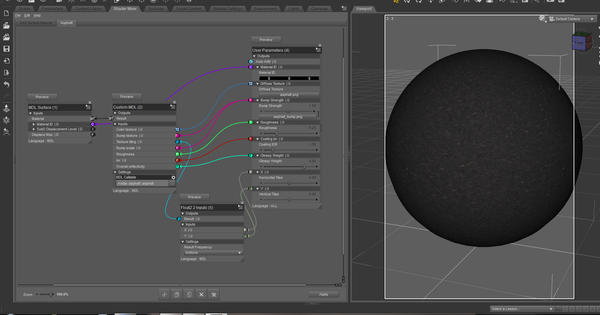

I've been importing some of the preset shaders that come with the latest version for Iray into Shader Mixer and I was wondering if anyone knows anything about the brick called Users Parameters?
It seems to be in all of the shaders I've imported but each one has different options.
Also when I tried to insert it into a mdl network it said that it couldn't be used in that type of network despite having ALL as the description at the bottom.
Does anyone know any more?

    If there's a User Parameters brick then only the parameters it shows will be in the Surfaces pane - it's an alternative way to control what is shown, and to keep everything together. If you drag a connection from its default V output to an input on another brick the right parameter will be added to the User Parameters brick - you can also alt-drag (opt-drag for Mac) a connection to add a parameter for every input on the target brick.
  • PendraiaPendraia Posts: 3,609
    Thanks for the response Richard.
    I understand what you are saying about what is shown on that brick is the only things that will show in the Parameters tab but don't really understand what you mean by dragging a connection from it's default V output?
    Sorry to be dense...just starting with looking at these bricks for Iray.

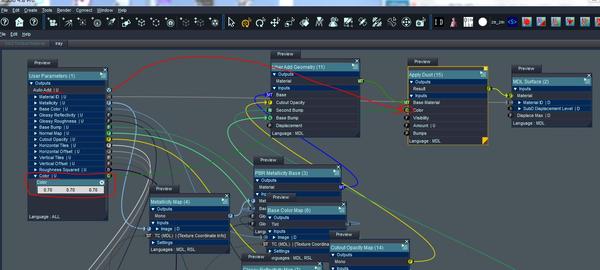

    Hi pen, richard said V means , in User parameters blick Outputs, there are "Auto Add | U " then the out put type "V"
    Now I add "Apply Dust blick" (I do not know how it work clear, but interensting,,,)
    then locate the blick between MDL Surface, and Uber Add Geometry.
    I think it maybe work ,,,,
    but I may hope to change dust Color, visibiltiy, amount in user parameter .
    then use Auto Add | U
    drug from out puts V (Auto Add) to "Apply Dust" input C (Color), (usuall connect way, when use shader mixer as you know well^^)
    suddenly it auto add the C "Color" parmeter in user parameter.
    connection line auto made.
    now I can twaek the Dust Color value in user parameter,
    (If I apply the new simple dust apply shader")
    I know we can manually add parameter first, then connect it. but the Auto Add may more easy to apply
    new parameter from blick input I think,,,

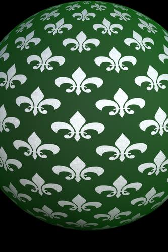

    So I realised I'd unplugged something by mistake. Plugged in the float to texture tiling on the custom mdl from the wooden mahogany shader I started with add a rough glass and this is what I got...how do I mix bricks using mdl?
    1000 x 1500 - 805K
    Post edited by Pendraia on
  • Richard HaseltineRichard Haseltine Posts: 108,412
    I haven't been able to play much but I think you'd use MDL>Material Editors>Layering>Add Weighted Layer. It's certainly the most obvious thing to try.

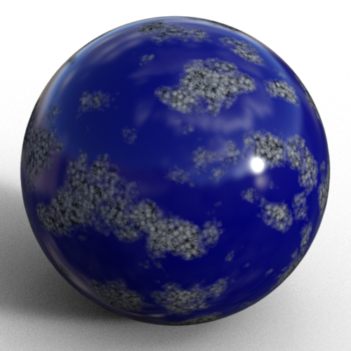

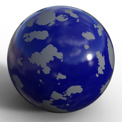

    Have created some layered texture maps (weighted layers), but moved on to trying layered procedural noise textures (for dirt / paint pealing / rust etc) as they do not need UV maps (can be object/world space)
    Still a long way to go, quick render of progress so far.
    1, simple procedural noise
    2, Layered procedural noise
    540 x 540 - 355K
    540 x 540 - 316K
  • MDM ArtworksMDM Artworks Posts: 7

    Sorry I lost notifications...this looks interesting any chance of posting the networks?
