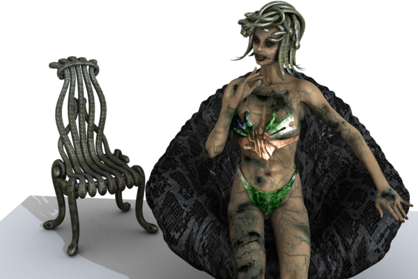

playing with my new Ninive.
her base resolution is set to high. and subdivision set to 1.
what is the difference between the mesh resolution setting and the subdivision?
i set her mesh resolution to base, she rendered faster but i could see the vert points in her shoulders.

    ? setting Victoria 3 to subd 4 doesn't help her in 3de renders, hard to tell with the Jartnia character :)
    Subdivision is just for smoothing meshes, it adds no detail; you're only increasing your render time due to the increase in polygons. Higher poly meshes do not need subdivision.
    trying to smooth her trouble spots without distorting texture detail.
