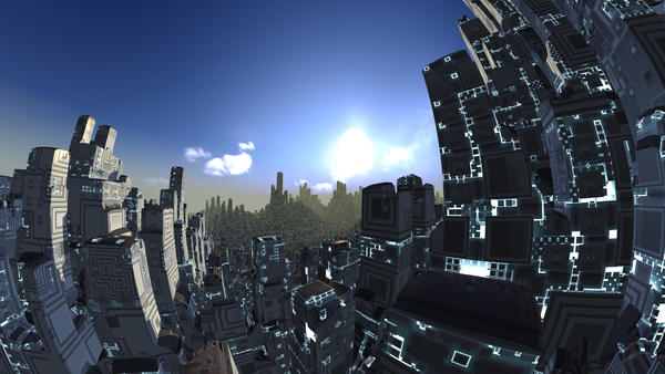

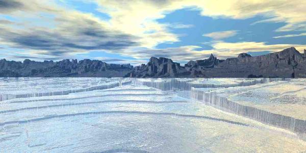

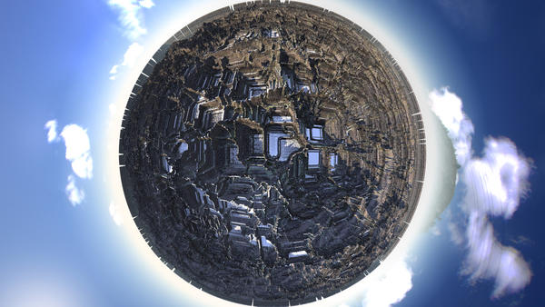

Since Horo has added the facility to record the steps taken with his Terrain Editor filter program. TE-Filters. It seems like the next logical step to share some of the results. This one created these squares, a bit like pixelisation effect, but with better transitions. The starting point was two 4096 x 4096 terrains, one a lava field t3_1 and the second an eroded valley t3_2 the result t3_3 is rendered below to show off the little squares. What follows is the recipe as recorded by Horo's software. Nothing very complicated as you can see, but it suffices as a test.
Recording started 2015:05:14 09:29:27
File | Open = C:\Users\David\Horo_filter_test\t3_1.tif
File | Load to Frame 2 = C:\Users\David\Horo_filter_test\t3_2.tif
Math | Add: 1=1+2 Auto
Copy | Copy 0 > 2
Filters | Sharpen strong
Filters | Expand strong
Frames | Rotate 1 > 2 > 3 > 1
Filters | Blur weak
Copy | Copy 2 > 3
File | Save (Frame0) = C:\Users\David\Horo_filter_test\t3_3.tif
Recording ended 2015:05:14 09:32:26
1511 x 850 - 2M
«1
  • HoroHoro Posts: 11,455
    Oh I like this "blocky" terrain, very cool. Just a second short of 3 minutes. Thank you for testing.
  • FishtalesFishtales Posts: 6,222
    Very nice. The Giants Causeway or Fingals Cave jump to mind on seeing that :-)

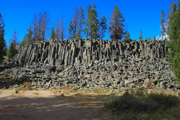

    That reminds me of debris from fallen Basalt pillars created by lava flows, such as these at Sheepeater Cliff in Yellowstone. I took this picture in 2010.
    1382 x 922 - 1M

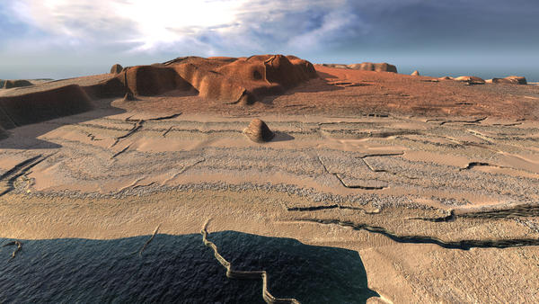

  • David BrinnenDavid Brinnen Posts: 3,136
    Impressive. How big were those chunks then? It is a bit difficult to guess the scale.

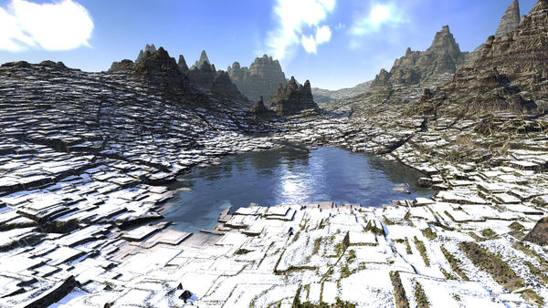

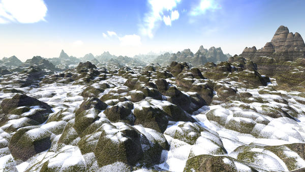

    Here's another little test/recipe. I used t4_1 alpine valleys 4096 x 4096 and t4_2 which was t4_1 eroded once in Bryce.
    Here's the first recording then.
    Recording started 2015:05:15 09:26:58
    File | Open = C:\Users\David\+grab this\Horo_filter_test\t4_1.tif
    Terraces | Strong from Lower 0 to Upper 32768
    Terraces | Pronounced from Lower 0 to Upper 32768
    Filters | Blur weak
    File | Load to Frame 2 = C:\Users\David\+grab this\Horo_filter_test\t4_2.tif
    Filters | Erode strong
    Terraces | Excessive from Lower 0 to Upper 32768
    Filters | Expand weak
    Filters | Sharpen weak
    Copy | Copy 1 > 3
    File | Save (Frame0) = C:\Users\David\+grab this\Horo_filter_test\t4_3.tif

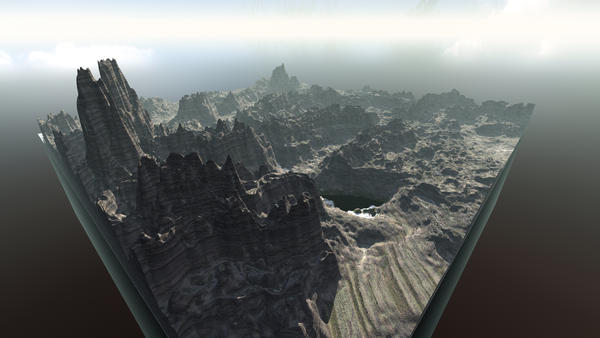

    Loading this into Bryce I found I'd accidentally generated a thin wall around the terrain. So I reloaded the result back into Horo's filter program and processed it a bit more.
    Recording started 2015:05:15 09:47:17
    File | Open = C:\Users\David\+grab this\Horo_filter_test\t4_3.tif
    De-Noise | 2 Pixels Edges
    Filters | Blur weak
    File | Save (Frame0) = C:\Users\David\+grab this\Horo_filter_test\t4_4.tif
    1511 x 850 - 2M
  • mermaid010mermaid010 Posts: 6,117
    These renders are so cool David. Thanks for sharing your recorded text, I will try them.
    -EDIT-
    Here's another shot that shows the scale better. It includes the ground area trampled by gawking tourists, um, which I was one of. The Ponderosa and Fir Pines should help you with the scale, if not the brush on the ground. The pillars are between one and three feet thick. The chunks are about eight to fifteen inches thick. The cliff is about 50 to 70 feet high, but basalt pillars can be hundreds of feet high ... depends on how thick the lava flow was. (Um, I'll let you translate those numbers into your British meters, but I'm posting this hoping they might get translated into BU's.) This lava flow happened about half a million years ago. As the lava cools, and the rock contracts, the mostly hexagonal columns form. Even columns hundreds of feet high are still between one and three feet thick. This cliff got its name from a band of Eastern Shoshone Indians know as the Tukuaduka, which means "those who eat sheep". Oddly, it was not sheep, but Bison they used this cliff to heard to their death for food, clothing, and housing material as recently as 180 years ago.
    That new render sure strikes me as an impact crater, (pun intended). Nicely done. Great program, that TE Filter.

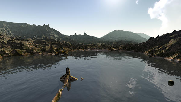

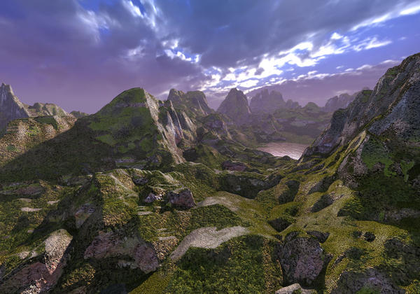

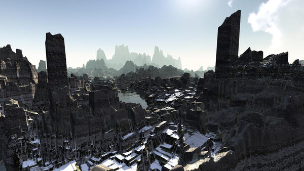

    Very interesting cliff that... OK here's another example/test.
    t5_1 a 4096 x 4096 Plant X procedrual terrain. t5_2 = t5_1 eroded once. And t5_3 some basic noise.
    During the making of this I did run into a Bryce bug that Horo has documented in his accompanying pdf and his fix did work.
    Recording started 2015:05:16 11:38:43
    File | Open = C:\Users\David\+grab this\Horo_filter_test\t5_1.tif
    Terraces | Moderate from Lower 0 to Upper 22937
    Filters | Blur weak
    Copy | Copy 2 > 1
    File | Load to Frame 2 = C:\Users\David\+grab this\Horo_filter_test\t5_2.tif
    Terraces | Strong from Lower 0 to Upper 22937
    Filters | Erode weak
    Filters | Blur weak
    File | Load to Frame 2 = C:\Users\David\+grab this\Horo_filter_test\t5_3.tif
    Filters | Blur weak
    Copy | Copy 1 > 3
    File | Save (Frame0) = C:\Users\David\+grab this\Horo_filter_test\t5_4.tif
    1511 x 850 - 2M
  • vivienvivien Posts: 184
    David - Thank you for sharing the steps to the filters. The terrains look great
    Horo - Waiting in anticipation for your filter program

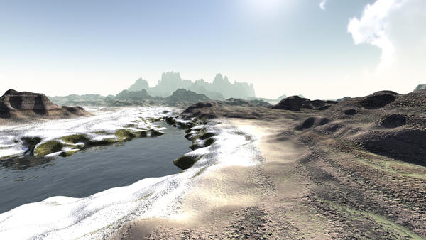

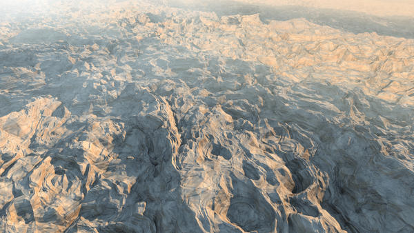

    t6_1 and t6_3 Warped Ridges at 4096 x 4096 t6_2 Mud cracks eroded once.
    The recipe used,
    Recording started 2015:05:17 19:44:44
    File | Open = C:\Users\David\+grab this\Horo_filter_test\t6_1.tif
    File | Load to Frame 2 = C:\Users\David\+grab this\Horo_filter_test\t6_2.tif
    Terraces | Excessive from Lower 0 to Upper 39321
    Filters | Blur strong
    Math | Add: 1=1+2 Limit
    Copy | Copy 0 > 2
    File | Load to Frame 2 = C:\Users\David\+grab this\Horo_filter_test\t6_3.tif
    Math | Multiply 2 by 2 Fold
    Frames | Swap 1 <> 3
    File | Save (Frame0) = C:\Users\David\+grab this\Horo_filter_test\t6_4.tif
    The result.
    1511 x 850 - 1M

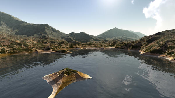

    CTippetts said:
    @David Brinnen - Wow! They're getting better. Would it be possible to see what these terrains would have rendered to under the same lighting and such BEFORE the TE Filter program?
    Yes.
    So here we have, in order,
    t6_1
    t6_2
    t6_3
    And the final result of the filtering and combination of these three terrains.
    1511 x 850 - 1M
    1511 x 850 - 1M
    1511 x 850 - 1M
    1511 x 850 - 1M

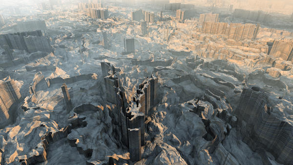

    In this scene I've kept it simple and used just one terrain. You get a before and after. So the source is 4096 x 4096 slickrock. t7_1 And the result is t7_2
    Recording started 2015:05:18 09:16:07
    File | Open = C:\Users\David\+grab this\Horo_filter_test\t7_1.tif
    Copy | Copy 0 > 2
    Math | Invert 2

    Copy | Copy 0 > 2
    Copy | Copy 1 > 3
    File | Save (Frame0) = C:\Users\David\+grab this\Horo_filter_test\t7_2.tif
    1511 x 850 - 1M
    1511 x 850 - 1M

    t8_1 = 4096 x 4096 warped zorch
    t8_2 = result of filtering.
    recipe
    Recording started 2015:05:19 17:28:17
    File | Open = C:\Users\David\+grab this\Horo_filter_test\t8_1.tif
    Math | Sub: 1=1-2 Fold
    Math | Invert 2
    Math | Invert 2
    Math | Divide 2 by 2
    File | Save (Frame0) = C:\Users\David\+grab this\Horo_filter_test\t8_2.tif
    1511 x 850 - 2M
    1511 x 850 - 2M

    t9_1 4096x4096 cauliflower hills
    t9_2 the result
    First render the starting point, the second the result from the same position and the third using the wide angle lens.
    Recording started 2015:05:20 16:55:43
    File | Open = C:\Users\David\+grab this\Horo_filter_test\t9_1.tif
    Math | Invert 2
    De-Noise | Opening strong
    Filters | Blur weak
    Copy | Copy 2 > 3
    File | Save (Frame0) = C:\Users\David\+grab this\Horo_filter_test\t9_2.tif
    1511 x 850 - 2M
    1511 x 850 - 2M
    1511 x 850 - 2M
