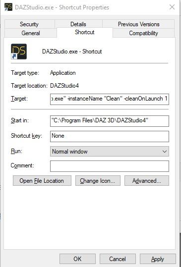

  • Richard HaseltineRichard Haseltine Posts: 111,701
    edited March 2022
    It doesn't matter what th shortcut is called, but the command line (in the Shortcut tab) is where you need to put the switches, in the Target field after the path to Daz Studio:

  • lululee1lululee1 Posts: 346
    Hi Richard,
       I apologize for starting that other thread.
    Here's the target name. I don't see the words -instanceName on mine.
    "C:\Program Files\DAZ 3D\DAZStudio4\DAZStudio.exe"
    If I change mine to "C:\Program Files\DAZ 3D\DAZStudio4\DAZStudio-Clean.exe" will that work or should I add the words
    If I change mine to "C:\Program Files\DAZ 3D\DAZStudio4\-instanceName DAZStudio-Clean.exe" will that work or are there other words I need to add?
    I really appreciate all of your help.
    Cheerio
    lululee
    The switches (-instanceName "Name" and -cleanOnLaunch 1) go after the clsoing quote, with a space before the hyphen - you have to add them (if DS was running you could use the script from the linked page to create the shortcut). If you have DS in the default location for an Install manager install the target line would end up looking like this:
    "C:\Program Files\DAZ 3D\DAZStudio4\DAZStudio.exe" -instanceName "Clean" -cleanOnLaunch 1
    HI Richard,
       No go. I put the above string in but the same thing happened. All is well until that flash of white, then no interface or window shows up.
