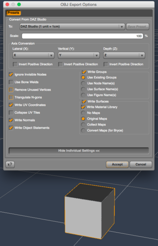

I am trying to form an object created in DAZ using a CNC router but I need more "resolution" to make it work. How do I increase the obj output size of content?

    You will need to first click Save to bring up the actual export dialog box, then click on the show individual settings in the dialog box to bring this option into view, then click Accept to complete the saving of the model to your computer.
    If you need to import from another modeling application then Studio has a list of preset scales and orientations to several popular 3D packages in the OBJ Import drop down or you can set your own manually.

  • vindazivindazi Posts: 671
    Is there a limit to the size? If I put 500, 5000, or 50000 percent the file size is the same.
