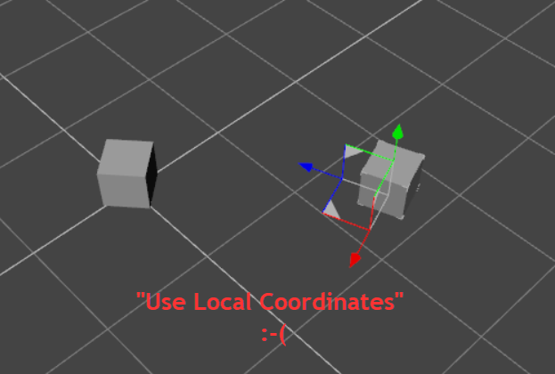

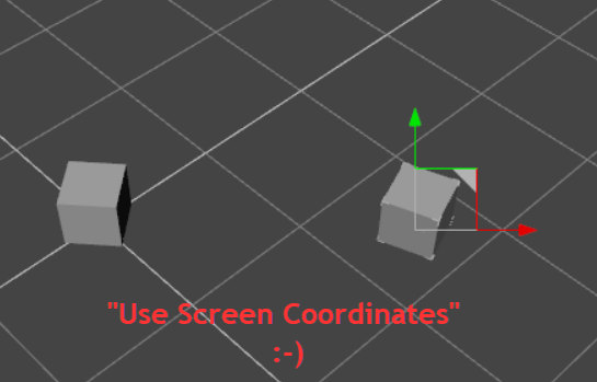

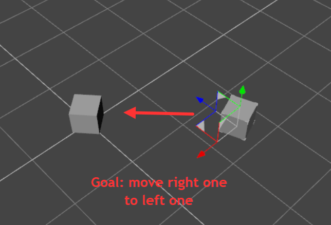

    One way is "Use Screen Coordinates" in Tool Settings. It was a bit confusing when I first used it, but since mastered it is very handy in various cases.
    644 x 438 - 74K
    623 x 420 - 67K
    559 x 340 - 53K
    545 x 349 - 48K

  • Another trick is to use the white triangle to drag the object in two planes at once. To re-use one of cgidesign's inages...
    The cube has red, green and blue axes, if you drag on the arrows that's the way the cube moves. But notice there are lines going at right angles to each axis, and where they meet there's a white triangle. For example, the read and blue axes meet at a triangle just below the base of the arrow in cgidesign's diagram.
    If you click on that triangle and drag it, you can move the cube freely across the red and blue axes, whilst it remains fixed in the green axis. I find this trick really useful when positioning items on a flat plane. It's sometimes handy to go into tool options and temporarily disable the translations and rotations that you don't need to make it easier to pick out the ones that you do.
