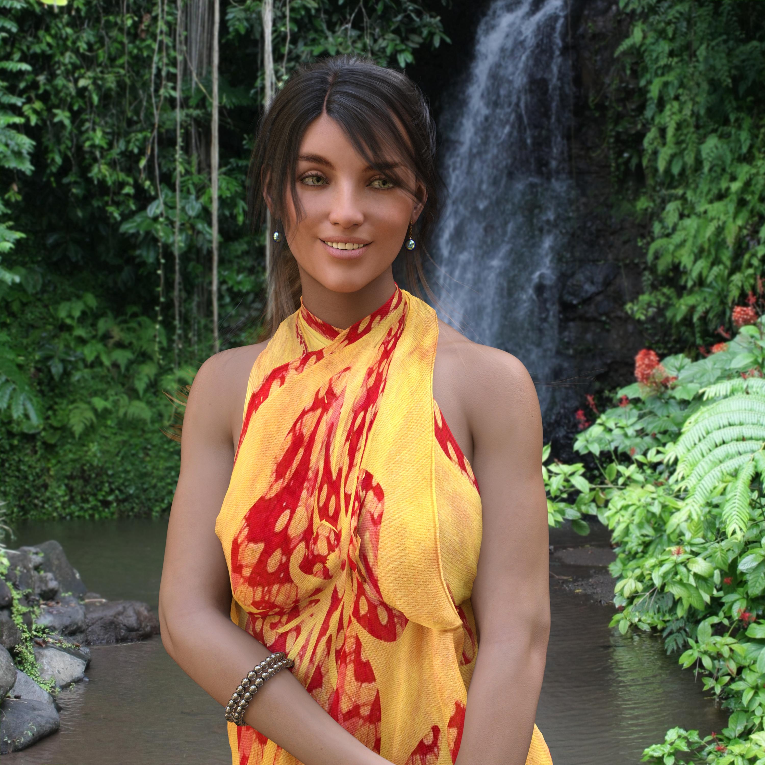

    Here is a portion of my render project to darker genesis 8.1 skin.
    I used this figure : https://www.daz3d.com/vyk-marty-for-victoria-81
    I'm quite happy with the result (thanks to @charles explanation).
    The problem I encountered is that the "map" (?) is not the same for the face and the body.
    So I had to use a different color for the Translucency color for each part. If I don't do this, the face will turn way darker than the rest of the body.
    @Padone : Maybe you have an idea of which slider I should use in order to get a more even color for body and face ?
    Thanks in advance
