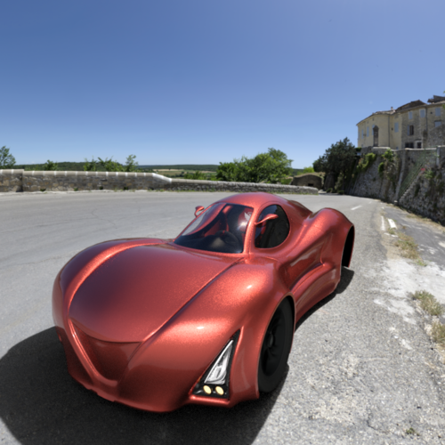

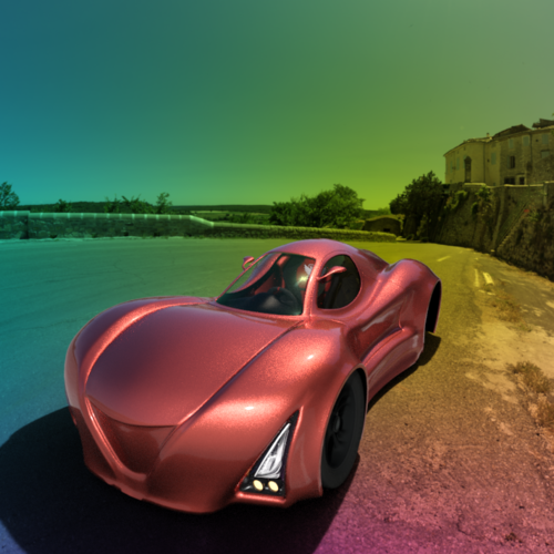

I've included an album with screenshots of what I'm talking about here: http://imgur.com/a/Xh0wm#4
The first picture shows how insanely large the HDRI I'm using is compared to the model. In this, I'm using the default infinite sphere.
I read on the main thread to try finite sphere, as it gives more options. The second picture shows that turned on with the sliders set to 0.
Third image is the radius scaled down into the negatives
Fourth image shows the scale multiplier scaled down.
Fifth image shows them both scaled down with a change in color with the map.
None of them have any effect on the map that I can see aside from the color change at the end. What do these actually do?

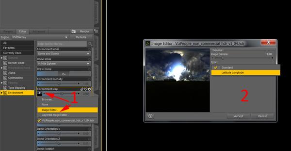

  • SzarkSzark Posts: 10,634
    load a HDRI click on the small thumb and chose the Image Editor...bobs your uncle. :)

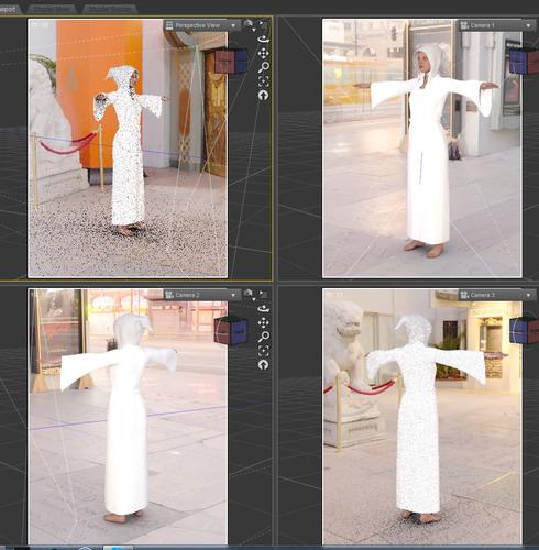

  • Richard HaseltineRichard Haseltine Posts: 111,677
    Is it really that huge? The foo dogs are big, but other elements look quite reasonable against a figure.
    1043 x 1065 - 189K
    It may be that the camera needs adjusting to match the camera used to take the image, though I'm not sure how great a factor that is with domes rather than flat back-plates.

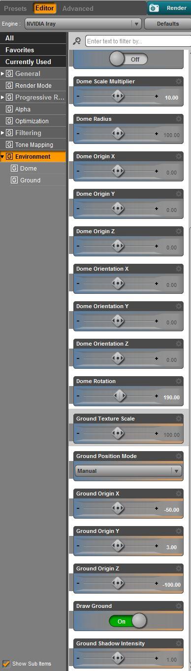

  • kitakoredazkitakoredaz Posts: 3,526
    DS unit of parameters  are usually "cm".. then "Dome scale multipler = 100 "change Unit as "meter" . but it only work about "sphere radius". sad
    eg when,,  dome scale multipler = 100 ,   then dome radius = 20.00  means,, current dome radius is  20cm * 100, = 20 meter.
    But when I need to translate Dome position negative  5 meter,  (m)  , I need to set value, - 500,   for Dome origin Y because,,
    those Dome origin (translate) unit still keep cm, not effected by Dome scale multipler.
