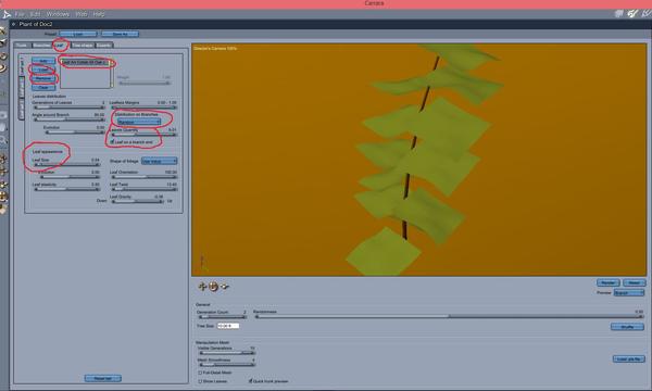

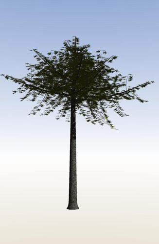

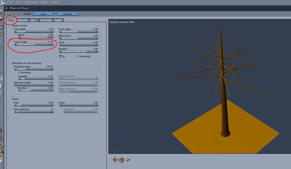

    Insert a plant from the top menu. Select the plant and enter the modeling room (click the wrench in the upper right. You will see a menu with tabs for Trunk, Branches, Leaf, Tree Shape, and Experts. Use these tabs to adjust the tree structure, load leaves, fruit, or other objects to be on branches, and other adjustments.
    I have included screen captures of the first 3 tabs. The trunk tab has an option to adjust the length, width, etc. of the trunk. I lengthened the trunk, which lengthens the distance from the ground that the first branches appear. You could shorten that distance. I also used the branches tab and leaf tab to lengthen the branches and increase the number of leaves and reduce their size.

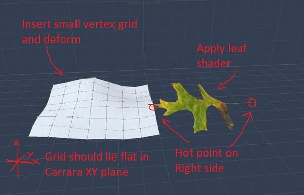

    To make the oak leaves, I started with leaf images from Art Collaborations that I had bought from the Daz store.
    http://www.daz3d.com/leaf-collection-vol-1-2-merchant-resource
    In a small scene, insert a vertex object and construct a 3D grid facing upwards (z axis) so that the grid les flat in the X/Y plane. Load your leaf images and apply them sideways to the vertex grid. The bottom of the leaf should appear on the right side (of X axis) and the top of leaf should appear on left side (of X axis). Move the hot point of the grid to the bottom of the leaf stem (right side of the X axis). Use the vertex modeler to morph the vertex grid a little so that it doesn't lie so flat. Save your leaf-grid somewhere you can find it.
    Use the leaf tab to LOAD (not add) your leaf grid. Note you could model a leaf obj rather than use the flat grid. You can use the leaf tab menu to change the size of the leaf and adjust how many leaves appear.
    I attach a render for a tree with a longer trunk, longer branches, a custom OAK leaf, and I also applied a procedural bark shader.

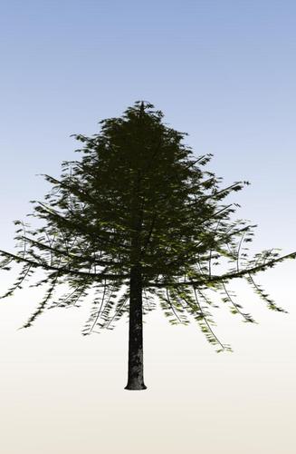

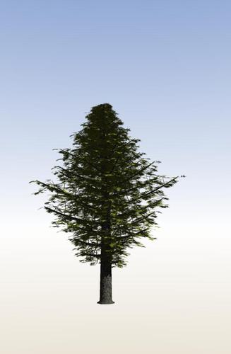

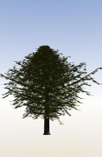

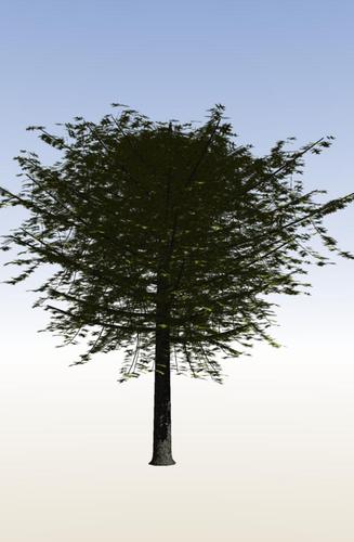

    And here is the same tree model with different trunk length / tree shape combinations.
