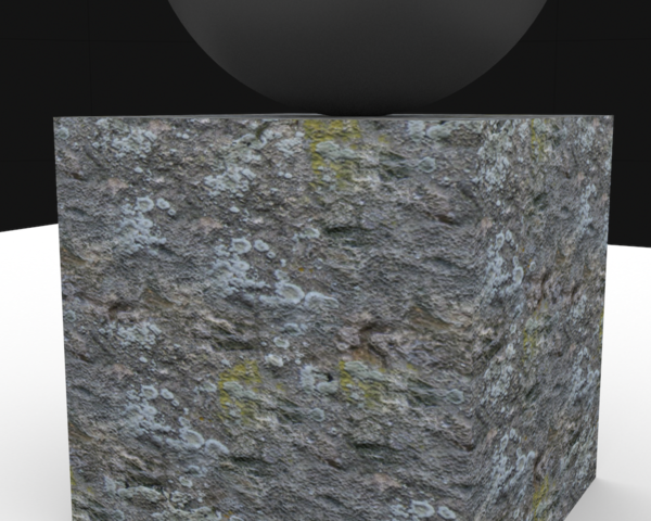

    Here's a render with maps made with AB.
    It has the 'height' map plugged into the Bump channel in DS, normal map plugged into the Normal channel. It's matte lighting model so the specularity map isn't used, nor is the occlusion map generated by AB.

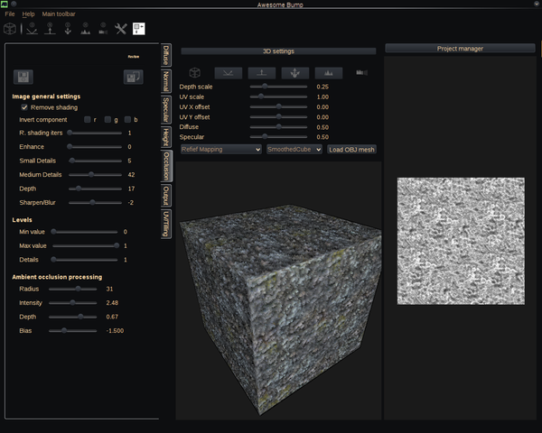

    There's a scrrenshot of the AB UI, too.
    1280 x 1024 - 611K
    1024 x 819 - 1M
